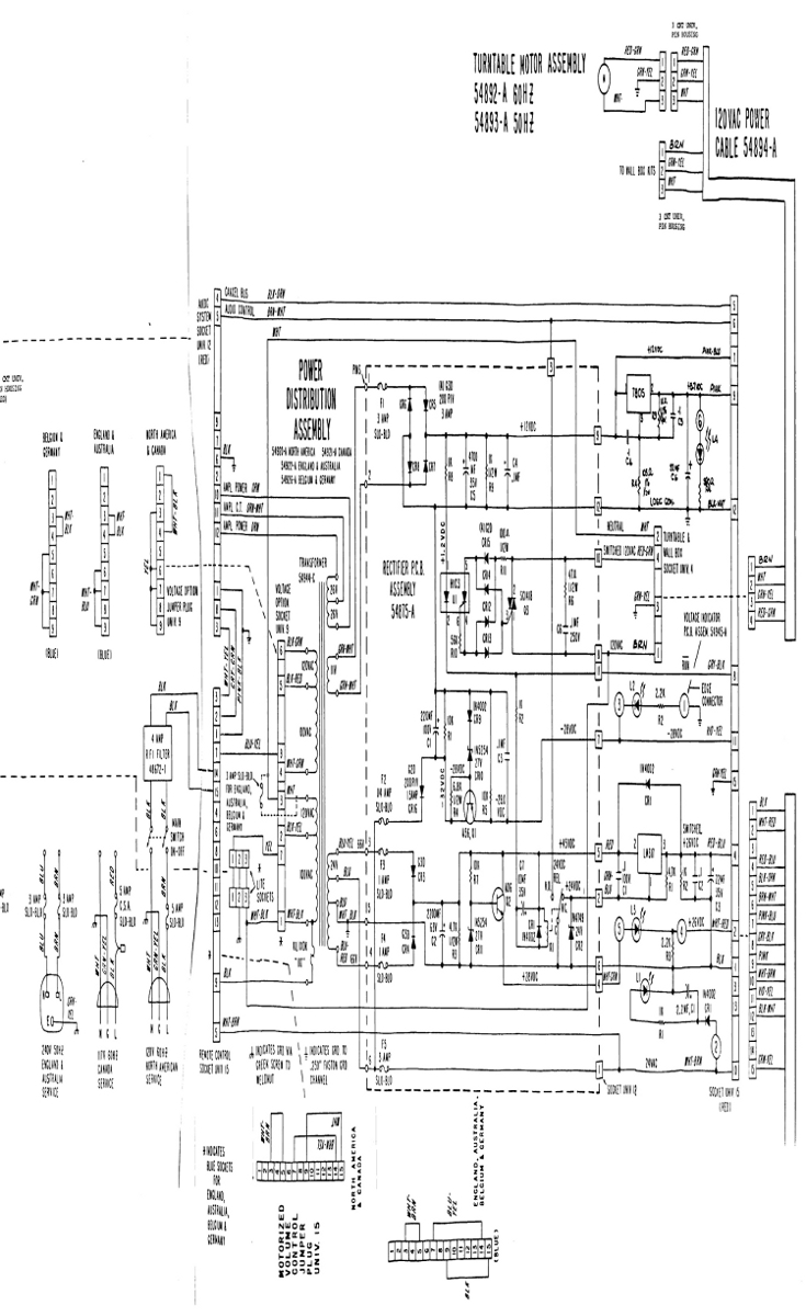

Fri Feb 06, 2015 9:05 pm
Forum: Jukeboxes
Topic: Rock-Ola 490 Turntable Motor Running
Replies: 4
Re: Rock-Ola 490 Turntable Motor Running
This is the page that covers it.
(314.29 KiB) Not downloaded yet
