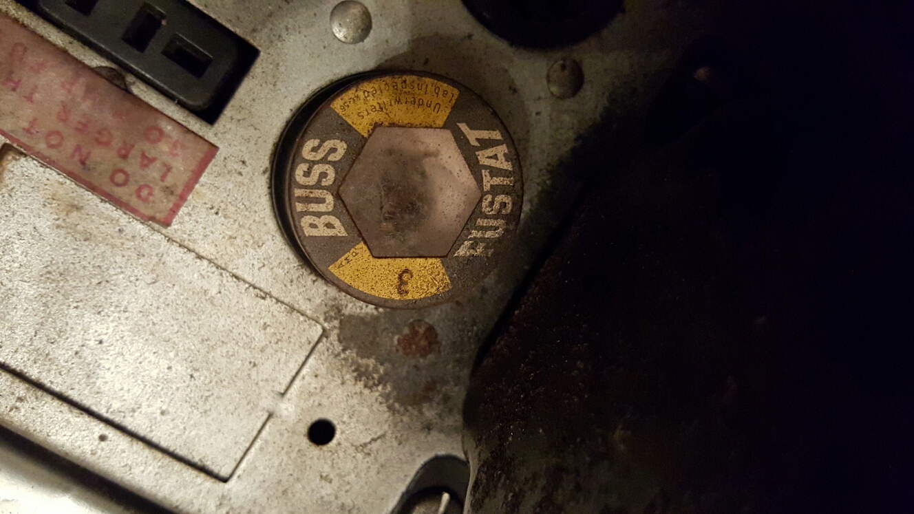

Any chance it is this fuse? I'm having trouble determining whether it is blown or not, because the glass is so cloudy.

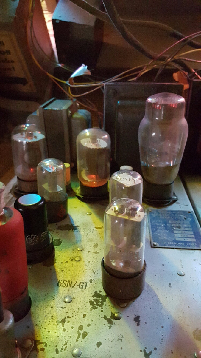

Ron,
All the tubes are pretty faint. The top of the 5U4 tube is light up, but the bottom does not appear to be. Maybe this photo (attached) will help.
