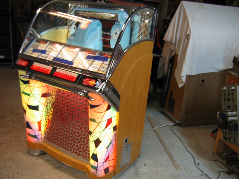

Re: Seeburg HF100G - problem selecting and playing record
Here is a picture of it before I brought it home in case anyone is interested. I am going to try to post a link to a youtube video showing what it is doing by this weekend.
Seeburg HF100G.jpg (168.56 KiB) Viewed 754 times
