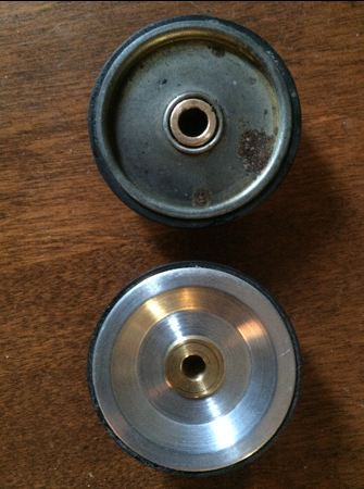

by Jon_Mtl
Fri Aug 28, 2015 2:23 am
Forum: Jukeboxes
Topic: Comments request : Why do I have to stretch this spring ?
Replies: 6
Re: Comments request : Why do I have to stretch this spring ?
Interesting Eddie, I believe that the rubber on my wheel is a little thin.
And I've been sent this new one : The hole is too small for the spindle ...

Fri Aug 28, 2015 12:08 am
Forum: Jukeboxes
Replies: 6
Ok. I removed the stretched spring, took another brand new one and attached it like it's supposed to and put the turntable on. Works great. I am amazed. I thought that I had to see the idler turns BEFORE putting on the turntable. I am a newbie :oops: On the picture one can see that the spring still ...

Thu Aug 27, 2015 10:18 pm
Forum: Jukeboxes
Replies: 6
Good day, This forum is always very helpful, so I submit this to your attention. Why do I have to stretch this spring so much for the idler wheel to spin along with the motor shaft ? I did ordered a proper replicated spring, this is the one you see on the picture. Any comments, suggestions, observat...

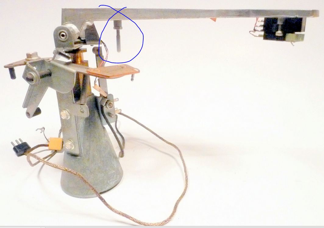

Topic: Reject issue : Tone arm is scratching the discs while rejecting
Replies: 7
Re: Reject issue : Tone arm is scratching the discs while rejecting
Problem solved, thank you guys !
P.S.: And to complete the adjustment of the Tonearm (the landing and rejecting) this clip helped : https://www.youtube.com/watch?v=gTlBOn_GswQ
Jean

Thu Aug 27, 2015 3:58 am
Forum: Jukeboxes
Replies: 7
Great pictures indeed.
Is the post you mentioned this one :
To answer to one thing you said, I do not see the ramp being warped.
Jean

Thu Aug 27, 2015 12:28 am
Forum: Jukeboxes
Replies: 7
Hi Rob,
I lost track of this post sorry, I was trying to fix the spring issue ...
Where exactly should I be looking ? Were you talking about he post under the tonearm ?

Forum: Jukeboxes
Replies: 7
Good day, Here's a little question for you if you have a minute, and perhaps it may help others in the future : When rejecting a disc, the tone arm of my Rock-ola 429 touches the disc. The needle scratches the disc and make that sound you do not want to hear when you care about your records ! The to...
