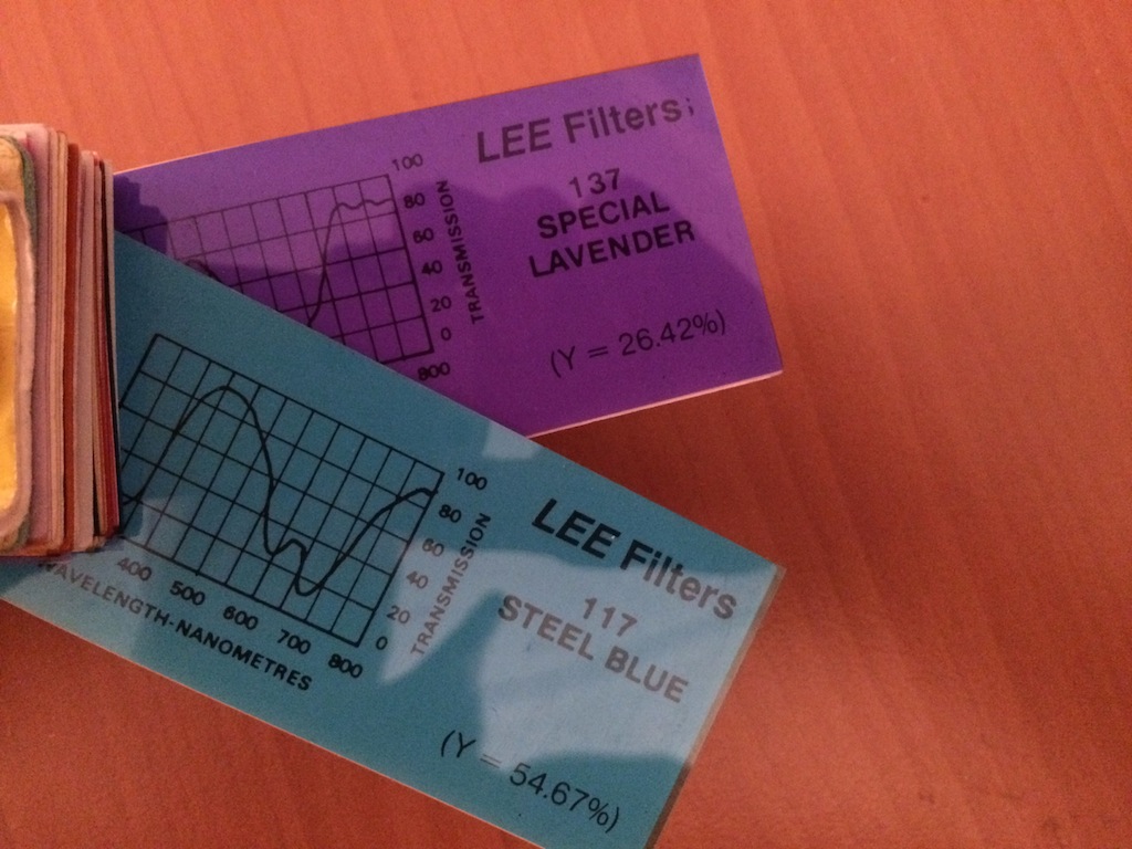

Re: SMC-1 title strips
Here are the foils I used. They are used in Theaters as filters for their Lights.
Friend of mine uses foils to color the lights in a theater. He had a sample book with all foils in it. I just matched the best looking ones.
I'll have to find the pictures of them. I'll post them shortly.
