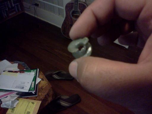

Re: AMI/Rowe Diplomat Cabinet part
The tiny bluish part is the piece to replace. It's found at the top of the spring and arm shown here.
I recently moved, and my movers unlocked the cabinet on my Diplomat to see how it worked. They didn't lock it back. Then, when they knocked it over, the cabinet flew open, shattering the glass. Additionally, because it opened so wide, there are 2 small plastic pieces I need to replace. I cannot find...
