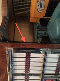

by 4Max
Fri Aug 07, 2015 6:32 pm
Forum: Jukeboxes
Topic: Weather strip / foam to cushion the cabinet glass on M100C?
Replies: 9
Re: Weather strip / foam to cushion the cabinet glass on M100C?
Quick update to say I am very happy with the weather strip I purchased. It went on easily, I think it looks neat, and appears, at least so far, to adhere well.

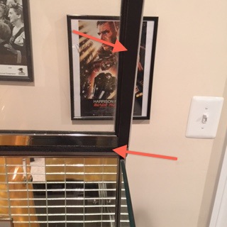

Sun Aug 02, 2015 6:28 pm
Forum: Jukeboxes
Replies: 9
Thanks, Ron
The 2nd photo is the front - here it is from a different angle...I'm assuming this does not require the weather strip?
