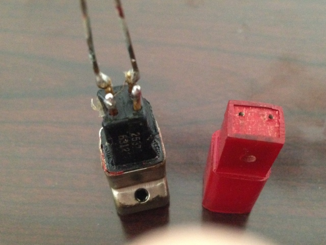

I have an adjustable temp Weller station and I used some wire wrap to add the other jumper, but it was impossible to get it back in the adapter case without snapping a lead. Too much glue residue! The 60hz hum is very minimal on the amp in play position, running, and the RCA removed. The hiss is muc...

I was able to take apart the adapter. I'm not familiar with the pinout, but shouldn't I be able to bridge both + leads and both - leads to convert this down to mono?
