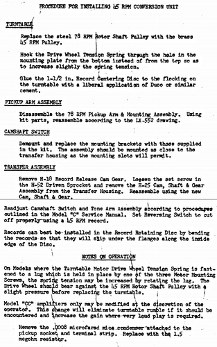

I found the procedure doc for the 78 to 45 conversion of the AMI Model C unit. It describes in detail what needs to change to the unit to play 45's and would need to backtrack to restore it back to playing 78's.

Well what I have found out is that the kits to convert the AMI C from 78 to 45's was an AMI produced kit for the operators to be able to quickly upgrade the unit instead of replacing it with a machine that could play 45's natively. As for parts, the biggest part change was the Cam. Apparently from w...

Well it has been a while since I have been on the forum, took a break from juke projects and have been doing a ton of video game restores until I picked up my latest project, the AMI Model C. Currently it is configured with a 45 cam but still has the original 78 tonearm. Here is my question, when th...
