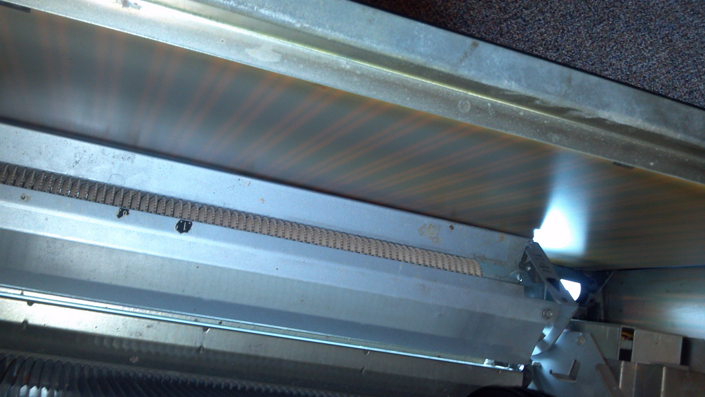

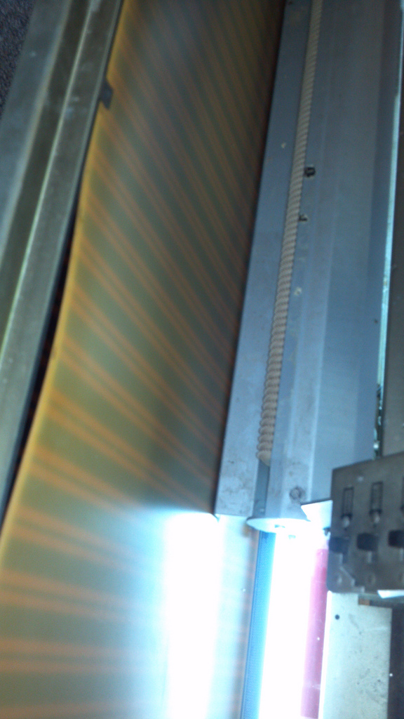

Sat Jan 07, 2012 7:23 pm
Forum: Jukeboxes
Topic: Seeburg USC-2 Bandshell cosmetics question
Replies: 10
Re: Seeburg USC-2 Bandshell cosmetics question
Here are some pics...
by amr
Sat Jan 07, 2012 1:04 am
Forum: Jukeboxes
Replies: 10
Ron Rich wrote:There should be a white/opaque diffuser, about 1/8-1/4 in thick, held in the frame, next to all bottom glass. There also should be a black metal screen diffuser covering the lower lamp. See the parts book---
Both of those are present - I'll post a picture shortly

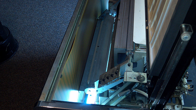

Fri Jan 06, 2012 9:58 pm
Forum: Jukeboxes
Replies: 10
Is there something missing in the panels on this juke? Maybe my bulbs are too bright? I can't imagine it being the bulbs because mine looks LESS bright than all the other pictures I've seen (mine looks down right dim.) This is mine: http://farm8.staticflickr.com/7156/6648642617_88b6298d01_z.jpg You ...
