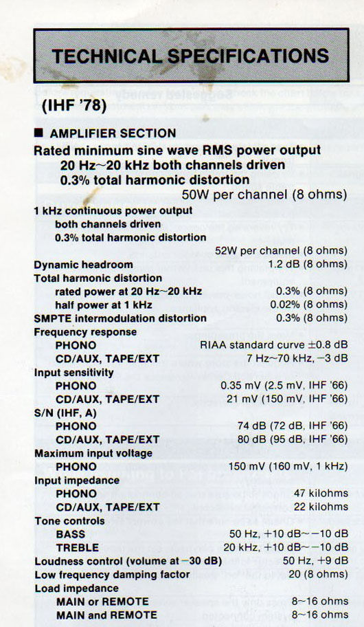

by FCVPI99
Sun Jun 10, 2012 3:54 am
Forum: Retro Record Players
Topic: need help
Replies: 17
Re: need help
i know you a tech and all but per SA-290 operating instructions
load impedance
main or remote 8~16 ohms
main and remote 8~16 ohms
by FCVPI99

Re: need help
ok cool thanks .. so is that gana kill my receiver? since the receiver is 8-16 OHM?

Re: need help
I may not be fully understanding the question here but, if this, or any receiver has two pairs of speaker terminals and switching that can allow both sets to be used at the same time (total of 4 spks) it can work into a 4-ohm load w/no problem. I gave away a similar receiver just before Christmas a...

MattTech wrote:Going by that diagram, those are all 4 ohm speakers in a magnavox console.
i dont want this to come off wrong
but how can you tell??
