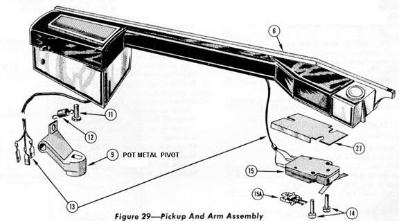

The spring/force isn't "adjustable" by bending the springholder, because on the RCA "Studiomatic" RP217/218's that this thread is about, and in consoles from 1962-1964, are made from pot-metal and will snap right off.
Diagram:
RCA Studiomatic Arm RP-217-218 series
