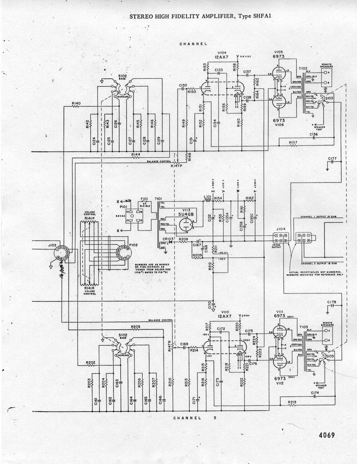

Looking at this schematic of the SHFA-1:
http://www.verntisdale.com/schem/shfa1a.jpg We can see the first ( C132) and second filters (C 135 sec-A). If C132 goes open or loses substantial capacity a 120Hz hum is the result. If any sections of C135 go bad those are likely to cause motorboating when the power output section draws power with a signal.
You can temporarily just jump a capacitor across existing sections (to ground) to check of the noise goes away. be careful about voltage and polarity. remember to check the bias-preamp supply caps C167 & c168. I always replaced the diode there as well.
