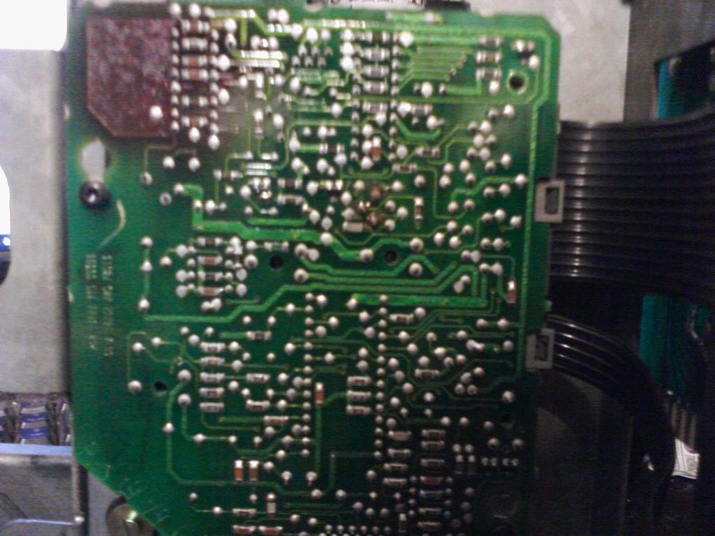

Cleaned up that mess. Everything mechanical seems to be working fine now... Notice the cd only stays on tray about 1 second and is then lifted and returned. And that the Cd motor seems to be dead. Not sure if the motor would cause the cd to be rejected so quickly and believe I have 2 problems somewhere... Grounds checked... external fuses checked... found an ice cube relay that had a bent pin from someone jamming it in wrong... now the cd rotates!!! but not at speed... Going to dig into that after I figure out if I am missing a wire from the cpu to the Cd player box.
There are 2 purple wires coming from the cpu at the cd connection. One goes to the cd box and the other one (purple with white stripe) has a quick connector with nothing plugged into it. I noticed that the plug on the Cd box is also missing one wire. I'm hoping someone has one of these machines and can help, because I can't make any sense of the schematics from rock-ola and they seem to be for a different model. "Nostalgic" series If anyone has links to a correct manual or simply could confirm I am missing something here I would greatly appreciate it. Love to see this thing working again. I know If I had the manual this would be an easy fix/answer, but for now after buying toys this week, I will be broke for a bit and hope someone could help me out with a quick look in their machine or manual. The first pin on the top of the connector on the cpu at the bottom side plugged in is where the purple/white wire with the connector is and the 2nd wire from the top on the cd player side plug is missing..... I think I may need to upload some photos...
