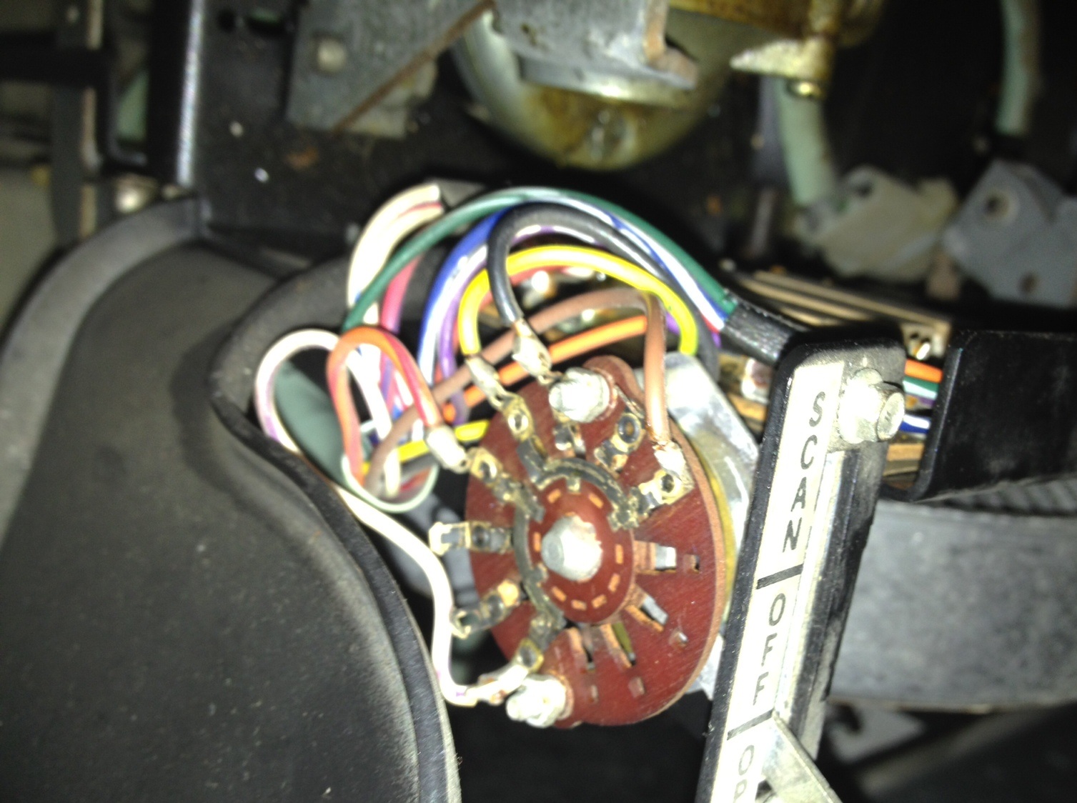

In sequence 16, the wobble plate solenoid appears to charge for only a second, the plate arm presses against the plate switch for a bit but then returns to its original position. In reading on, it appears the solenoid is supposed to remain energized and the contact should remain throughout play, so not sure what is wrong there.
Also, the switch may not be wired correctly. I've uploaded a picture. Is that correct? I followed the schematic, and it seems like the brown wire is supposed to connect to the yellow and green wire, which reaches the play control relay (when switched to operation mode). I don't think my switch is wired for that, but it also does not look tampered with in any way, so I may not be reading it correctly.
Again, any help is appreciated.

by casl37 » Thu Sep 27, 2012 4:00 pm
Switch
(384.9 KiB) Not downloaded yet
Re: Rock-ola 448
by ami-man » Thu Sep 27, 2012 4:14 pm
Hello Carlos,
I have not worked on Rock Ola jukeboxes for years, but the servce switch is the same type that is used on Rowe Ami and for that matter Fender Guitars.
Usually these switches switch AC voltages at one side of the switch and DC on the other side of the wafer switch (only on jukeboxes). Te switch is very dirty, I suggest that you clean it up with a pencil rubber (eraser) and check that the contacts are good and that the voltages are present.
