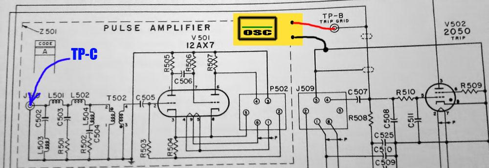

I unplugged the Tormat RCA connector from the Pulse amplifier. I ran a jumper from the RCA input jack, made a selection and as the mech is scanning I touch TP-C with the jumper. TP-C's function is to provide low voltage for the test. The mech did not trip.
Next on the list was to start the mech scanning and touch TP-A to TP-B. This grounds the grid of the 2050 tube. The tube conducted and the mech stopped scanning and loaded/played a record.
Next on the troubleshooting list is the 12AX7 tube. I tested the old one, and one side of it was bad so I put in a new one from my stock. TP-C still would not trigger.
Next on the troubleshooting list was to replace the 2050 tube. I don't have one and I wanted to be sure that was the issue. I set up a test as indicated in the picture, hoping to see a reaction in my scope when I applied TP-C. No reaction at all. Hmm......
I removed the Pulse Amplifier and found plate load resistor R505 open, grid bias R506 open, R503 and R504 way out of specification. I replaced those all along with R507, and a new coupling cap C506. I tried the amp again using TP-C but the mech still did not trip. I then removed the Tormat Controller and replaced the coupling cap C507. It still won't trip with using either the RCA jack plugged in, or TP-C.
But I did find that I can jump the Pulse Amp input and scratch it onto a 1.5v "AA" battery and that DOES trip the mech. I am assuming the battery is saturating the output of the 12AX7. I apparently have a clear electrical path to the 2050, so I have ordered two of them and hopefully get them by the weekend.

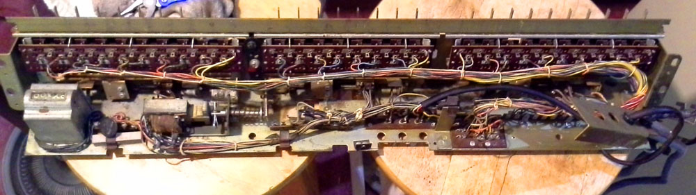

I have begun servicing a different part while I wait for the 2050's. I've removed the filthy/grimy Tormat Selector unit from the jukebox. I discovered how to partially disassemble it... remove the 3 switch groups, the treadle bar switch assemblies etc. I washed them up very well using a dish soap & water solution and a toothbrush. I was careful not to get the latch solenoid or counter unit wet.
I blew it dry and let it dry overnigh in a low humidity room.
I polished the metal frame this morning and fixed the rusty spots. I put a small dab of Teflon grease on the stems of each selector switch and a spec of Teflon greason on each latch bar hook.
The service switches needed a lot of help. The slide switch was so bad the spring wouldn't return it back to off. I took the slide switch apart, cleaned and polished it. I did the same with the selector switch. I polished its mounting bracket.
I reassembled the Tormat Selector unit and the only thing left to do on it is to adjust the 3 Treadle bar switches. I am so glad the manual covers their proper adjustment.
Here's a pic of the schematc for testing and where I was looking for a Pulse Amp output signal on my scope, along with photos of my "baby"- and it's freshly cleaned Tormat Selector unit.
Any suggestions are very welcome:

The right approach in these sorts of cases is to start from the end point: what actually trips-detents and plays a disk. You did that by grounding the thyratron grid.
This is followed by placing the negative end of a standard battery (AA-C-D) against the chassis and touching the tip of the pulse map's RCA plug to the positive end a few times. This will flip all Toroids to the "selected" state. Place the RCA plug back in the P.A. and start the mech scanning -make sure the service sw is in the "normal" or "play" position. The mechanism should trip at the first slot it finds. Press reject and see that it will trip at at least a few others in succession.
If this fails to happen first make sure there is a readout pulse of minus approx 300 vdc at the plungers that ride under the Tormat. the rear plunger is for the "A" sides the center ones are ground return and the one closest to the front of the mech is for "B" sides.
The 12AX7 is AC coupled via a transformer so the battery DC would not reach the grid. What it did do was create a pulse similar to what a flipped toroid would do when read out by the mech.
The pulse amp is actually a set of filters designed to eliminate all the extraneous electrical noise and a form of multivibrator to lengthen the output pulse to be sure the mechanism and a long enough trip pulse to react.
If you have a test amplifier with reasonably high gain, charge the Tormat as above, connect the RCA plugs from it to the input of the test amp and listen for the pulses as the mech scans. The readout pulses are louder and distinct from the other noise that occurs as the mech scans.
Have the amp and selection receiver been rebuilt? That really eliminates a lot of these sorts of minor problems and is critical to preventing damage to the units.

I have a BNC to RCA adapter on my scope. I can flip the memory unit with a "D" battery then make a selection in "Play" mode with the RCA jack plugged directly into my scope. The carriage scans twice but I see no reaction at all in my scope through the RCA jack. Flat line no matter how sensitive I put the scope input. I did a resistance measurement on the RCA jack tip to gnd and get about 2 ohms. The jack is wired so the shield and red wire are soldered to gnd and the green wire to the tip.

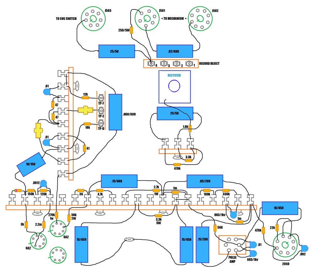

I took the time to map out the component connections on the controller and identify bad resistors and build a shopping list. I replaced 6 resistors, 3 of them were completely open. I also replaced all the Litic/Paper caps. I put it back together and ZINGO! the mech picked up the 1st record in the line, I rejected it and picked up the next one etc. Looks like it's working perfectly. Woohoo!
I really, really can't convey my excitement here. I am beside myself. You guys are really the best of the best!
I will attach the component map I made in case it might help anyone else. Now that it is working properly I can get to the rest of it. Namely, I need to check resistors and recap the Amp SHFA4, the stepper RCSU2, the speed control TSAU1, single pricing unit and service the mechanism. Someone had cut the lead to the popularity meter solenoid so I'll have to investigate that.
I am -so- blown away by this working and again, thank you from the bottom of my heart! :!:
Controller wiring map

Seems like this model was made right at the time many carbon resistors have started failing big time nowadays. I would not be surprised if you find more that have gone way out of tolerance or just plain open circuit.

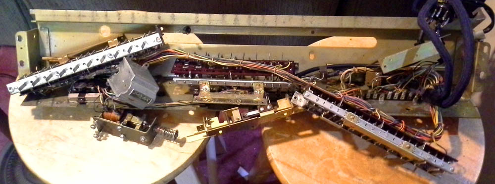

I will be servicing the mechanism next.
Question.
My detent switch is pretty burnt, not very much contacts are left. I have new contacts on hand which are designed for use in electromechanical pinball machines. One type is a silver alloy- gold flashed and designed for lower current use. I have new contacts which are of a much harder material- tungsten faced, copper backed for high current applications. I will attach a pic of them.
Can I use the pinball contacts to rebuild the detent switch? If so, which set would you suggest?

Original contacts were silver--not flashed, so either should work just fine--however, you will find no "mounting hole" in the blade as the contacts were fused to the blade.
Slight warning on your map--all of the TSU's may vary in different production runs as to component placement. Ron Rich
