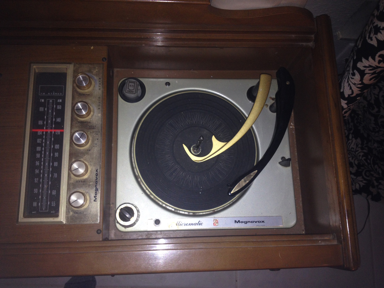

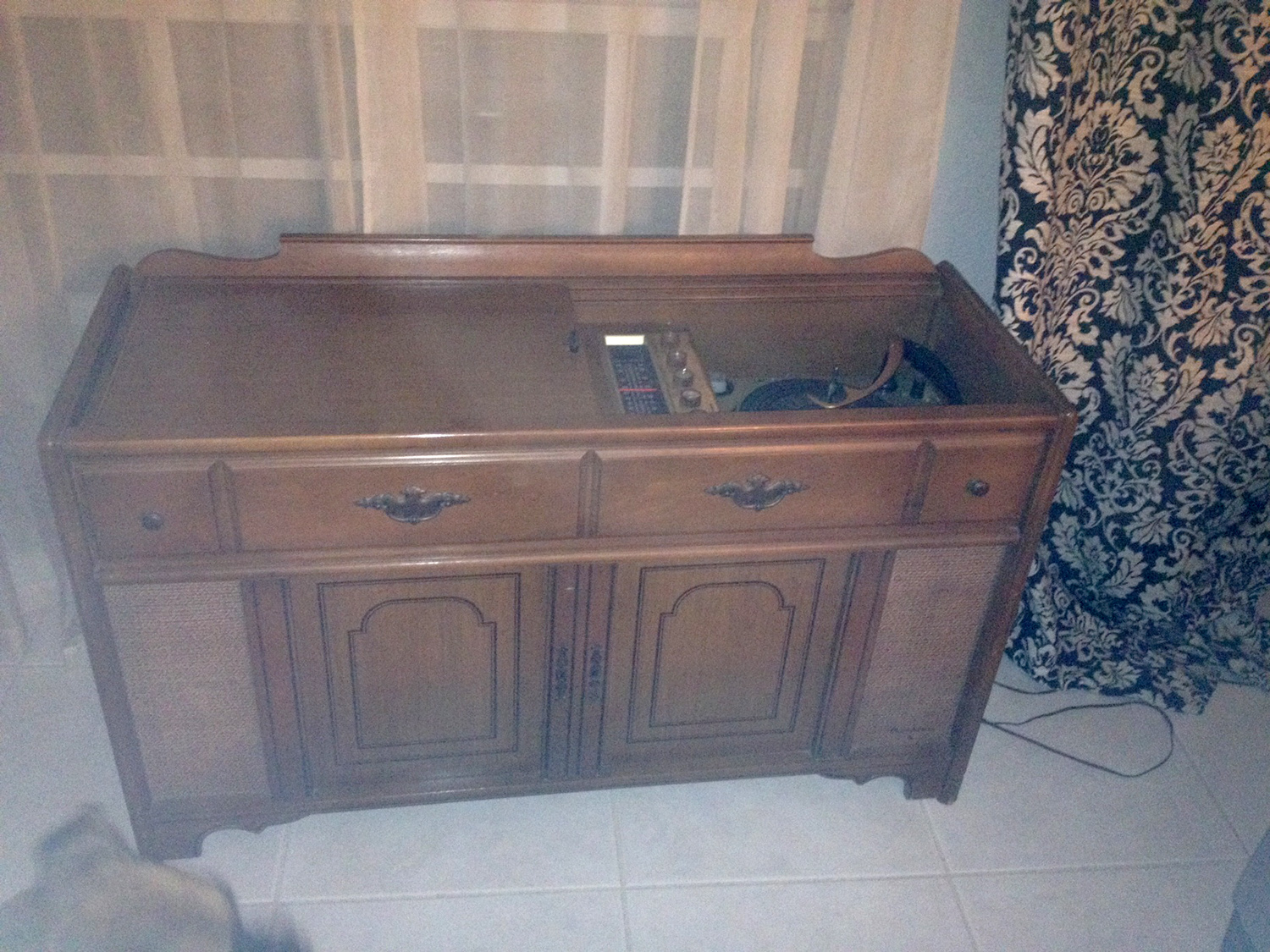

by NikkiMayDay » Sun Feb 23, 2014 7:02 am
Here are some pictures of the turntable

Re: Magnavox Micromatic Cartridge and Needle
by MattTech » Mon Feb 24, 2014 6:56 am
I can see in photo #2 WHY it needs a new needle.
I can't understand why people set the DELICATE and FRAGILE stylus ON THE BARE TURNTABLE.
There's a restpost/security clip to the right of the platter - THAT is the proper way to store the tonearm when not in use.
The stylus is only meant to touch a revolving record.
That being said, those photos still doesn't give me a clue as to what cartridge is in the tonearm - since Magnavox used numerous brands/models of cartridge/stylus in that tonearm.
And the fact that it could have possibly been fitted with another cartridge altogether in a previous service instance.

GENTLY lift tonearm as far as it will lift with one hand, with the other hand take your camera and shoot picture of cartridge and needle. send picture of cartridge and needle to one of the sources in the above stickys. that should get you the correct needle. good luck.
by HarryO » Sun Mar 02, 2014 10:28 pm
From the several Maggies that I've had, many had ElectroVoice Cartridges with either #26 or 126 needles as I recall. These were flip under cartridges which had two separately replaceable needles. They are still readily available for both LP and 78. Good luck on finding a good cartridge however. Sometimes after replacing a needle you will find that the little groove in the cartridge which supports and receives the needle has deteriorated and will not allow the needle to work correctly. I've had a few good ones, and many bad ones. It is amazing the degree of difference between various old cartridges. I suppose heat and humidity have a great deal to do with how they may survive or not.
