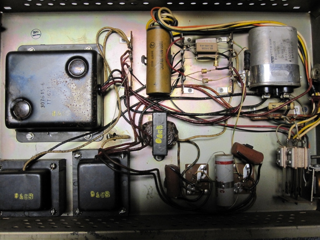

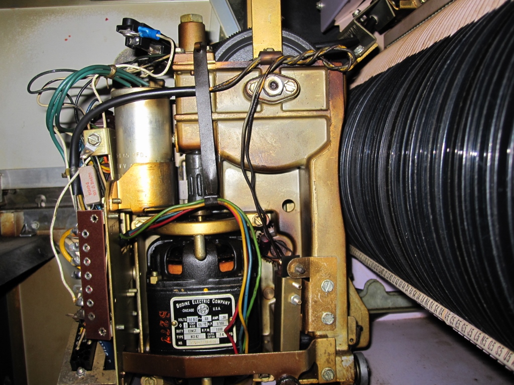

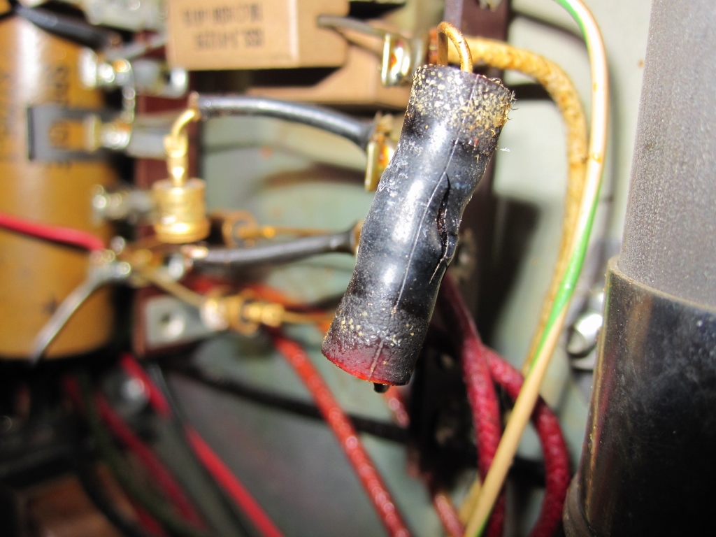

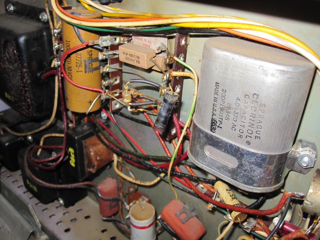

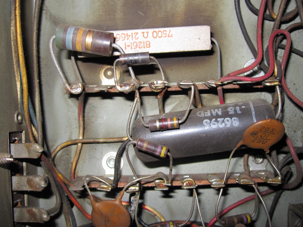

So... it's been about 4 years since I last posted and I've done nothing with my SS160 besides buy the service manual. In fact, it's been so long that when I googled and found this post I read the whole thing not even realizing it was me who started it!! I found a gentleman that used to service jukeboxes, games, etc and he tells me he knows all about the jukebox. I'm going to have him check it out, but wanted to post a couple pictures for review. I see at least one transistor (??) that is definitely bad, but maybe another as well. Maybe someone can spot other problems. I'm still in need of a tone arm to replace my red one if anyone has a source.

Re: Seeburg SS160
by Rob-NYC » Sat Mar 01, 2014 3:03 am
"strosk" that machine is now 47 years old and from your pics, it appears not to have had any service or rebuilding. It is likely to have serious failure if left in this state.
The good news here is that both the control center and speed unit contain few components that will actually need replacement.
The amp is another matter. If you are familiar with transistorized equipment the repairs here are straight-forward. If not, I suggest sending it to someone who is experienced in rebuilding these old juke amps. That amp is not operating anywhere near it's best at this point.
And NO, you do not need to replace the red tonearm assembly. (:-))
Re: Seeburg SS160
by Ron Rich » Sat Mar 01, 2014 3:09 am
Hi Strosk,
I see one RESISTOR that appears as if it may be bad--which, BTW, should be replaced with a 4 or 5 watt unit--
The tone arm assembly is a mater of opinion--Seeburg's engineer's, and I, agree that the red tone arm was defective-
Rob/NYC seems to think differently :roll: ??

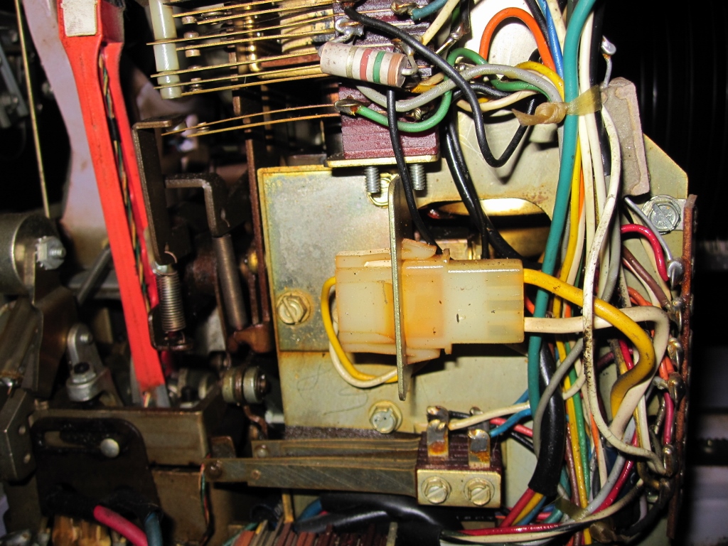

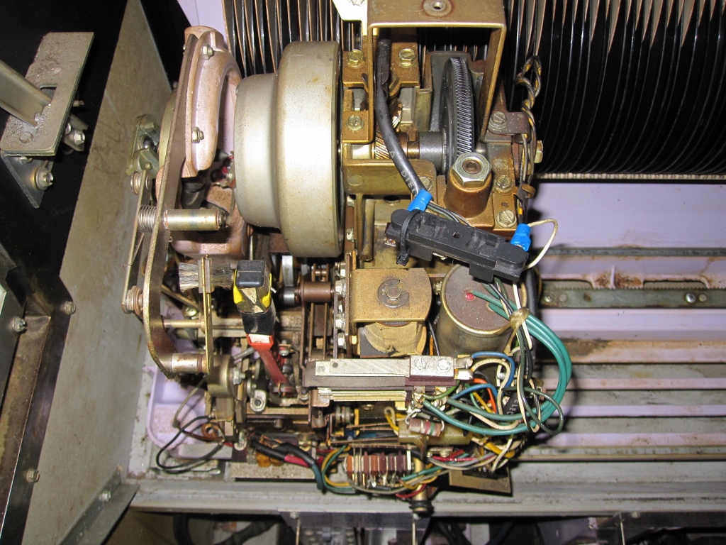

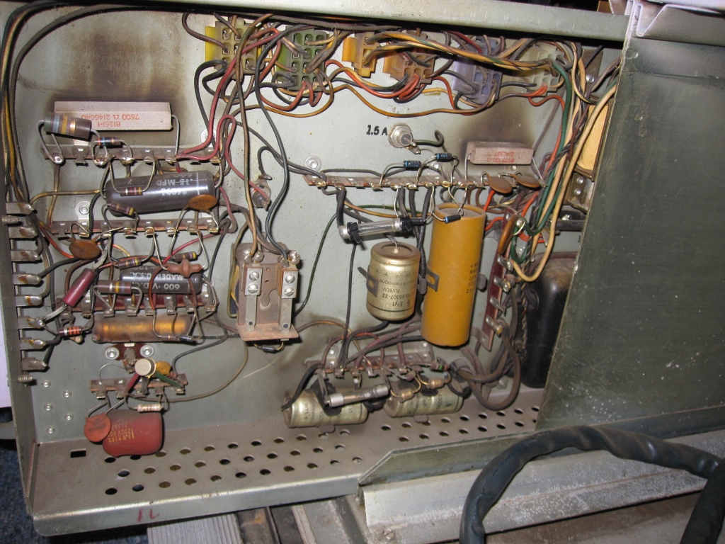

Here's a few more pictures... added some of the mech as well.

Re: Seeburg SS160
by Rob-NYC » Mon Mar 03, 2014 6:59 pm
The main candidates for replacement are capacitors.
For instance, on image 2130 you see several gold-silver and cardboard covered caps along with two black ones along the terminal strips. Those, along with checking and possibly replacing two known troublesome resistors are about "it". Not a lot of parts there.
The speed unit has even fewer, mainly the two large caps.
The amps is considerably more complex.
Do you have a schematic for each unit? If not, I can scan-in the data from the original pages.
The mech looks bone dry.
