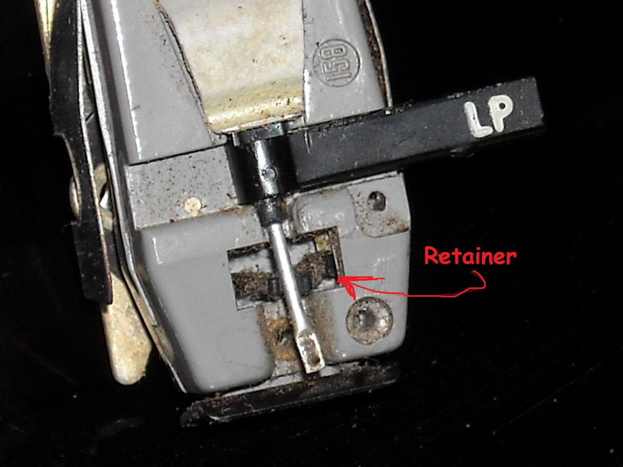

Newbie here. So after it being in my family for 44 years (20+ of that in storage), I bought replacement needles for my Astrosonic and went to install them last night. When I did, a small piece of plastic popped out when I took the needle out. Since I couldn't see the underside of the cartridge when I was doing the work, I don't know where this piece should go, and if it can even go back in at all!! Help!!!
I've included pics below - one with the needle for scale, and the other of just the stray piece, which has kind of a wishbone appearance (click on the pics for hi-res versions). Thanks for any assistance you can offer.

Looks like you are having a bad day. That's the retainer for the needle.

Thanks for the info and pic. So can I just put this back in? The same piece? OR is this now damaged and I need a new one?

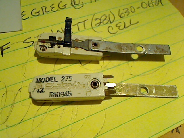

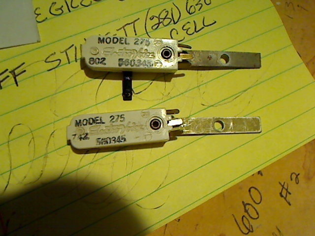

I see that you got one of those needles with the longer rear "stem". I mistakenly bought some of those and had to use some nail clippers (for a quick fix) to shorten that rear portion.
That "retainer" thingy can be slid back on the two connections carefully with some tweezers. I would maybe use some type of rubber treatment on it to keep it pliable. Just for a few seconds. Some of that stuff can be pretty strong.
If you have a newer Micromatic (W620/W621) with the skinny tonearm that uses something lika an EV275 or Astatic 165D, just loosen the single screw underneath that holds the cartridge in place. If you have an older Micromatic with the black, curved tonearm with one of the larger cartridges, loosen the screw on top of the tone arm and the whole assembly should fall right out. That way, you don't have to do contortions getting a neckache and backache looking upside down under a tonearm that doesn't pull back completely.
I've got three different needles with subtle differences, but they all work, and the EV275 has the numbers 742 and 802 which I am clueless. I recognize the Magnavox 560345. Notice the rear "stem" on each.--BB

The only thing I would be concerned about is the two broken ovals that fit over the ceramic bars. They should not be split like that and may be why it fell off.

By way of an update, I did in fact manage to slip the retainer back in (after about 30 minutes of effort) and the needle in over it. Your input saved me $75-100 for a new catridge!

As I looked at that pic again, I noticed that the ovals were split. Well, I did notice it the first time and didn't think much of it, thinking that was the nature of that particular cartridge...never seen anything like that before. Maybe the thing is dry and brittle and may crumble to pieces if you try to remount it.
Would it be possible to soften it up, then maybe use a tiny drop of Super Glue to close the ovals? Hell, I'd give it a shot. I've made alot of lemonade out of lemons throughout the years. Desperate times call for desperate measures (if you're desperate...LOL). Even if it did work, those ceramic bars could be bad. I think that's the issue with some of these extra deadbeat cartridges I pictured. The volume will drop real low on one channel, and when you gently tap or press the top of the tone arm (bad for the record while it's playing), the channel pops back to normal volume.

The piece was very pliable, and I don't know how I might have gotten it back in had the ovals been closed, since I had to use a pin to push the open ends around the ceramic bars. I did see a little ceramic dust come off on the pin when I scratched the bar by accident, but I just finished listening to a Claudine Longet album, and just put on AC/DC and it's sounding great!
