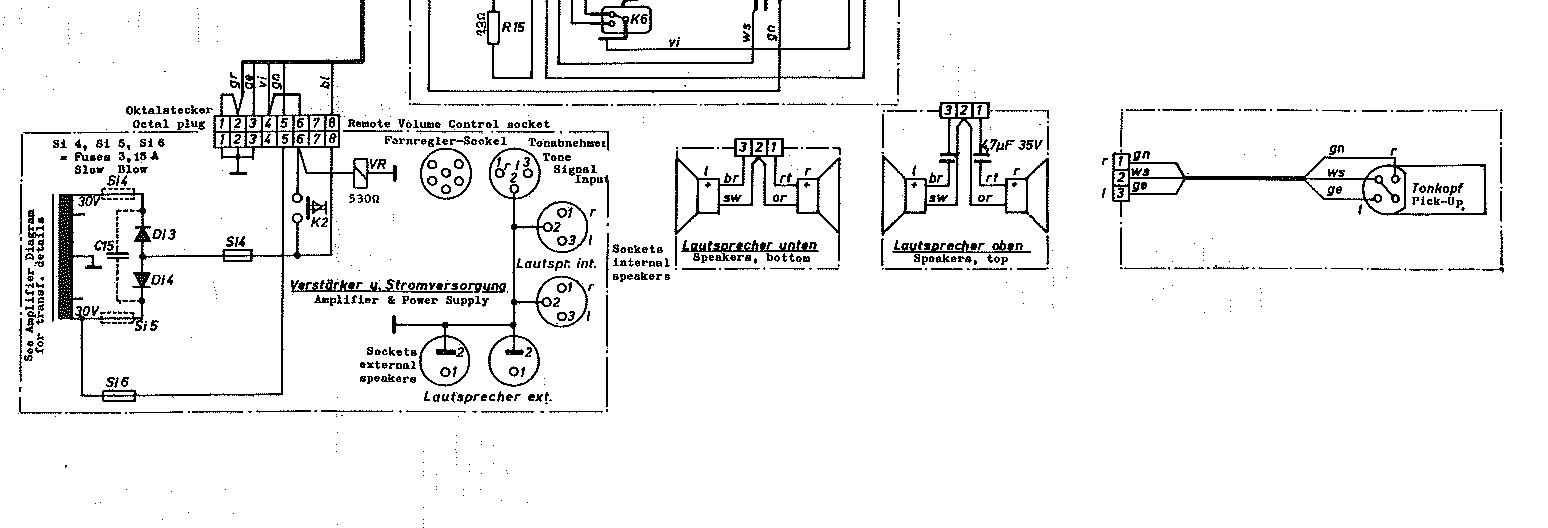

Another idea: The speakers are connected right, aren't they?
The attached diagram is part of the 1977 wiring diagram.
in general, a service manual could be helpful. It explains the functions, adjustment, lists all parts, schematics and even offers a trouble shooting section.
Check with Victory Glass for their manual #3470 for all 1977 models by the Deutsche Wurlitzer (they list it as GmbH W. Germany 1977 Models Service, TS Guide and Parts 104 Pages).
Hildegard
Speaker connection X5
(141.13 KiB) Not downloaded yet

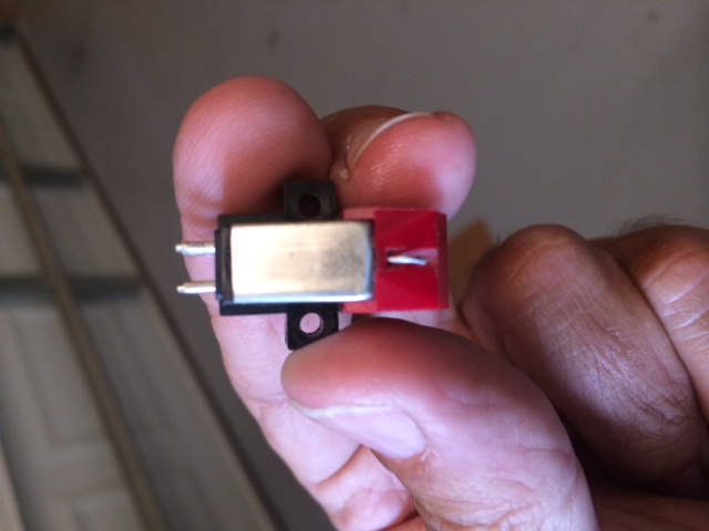

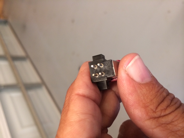

I ordered another cartridge to try but it ended up being the wrong one, I will include a picture of the one in this jukebox.
X 5 cartridge 2.jpg (81.49 KiB) Viewed 387 times
X 5 cartridge.jpg (74.82 KiB) Viewed 387 times

I am sorry we did not see this picture before when I first posted a photo of the Philips cartridge and it's replacement. They look different. The cartridge you show is a magnetic one (I don't know which one). Those two cannot be interchanged without modification.
If this magnetic works with the original amplifier, then there should be a preamp intalled as well. Otherwise the magnetic cartridge with it's low ouput (10 - 15 mV) cannot work with the amplifier equipped for ceramic cartridge (ca. 200 mV).
Which cartridge did you get now? P-132D is a ceramic cartridge and would match the amp well if still in original condition.
But if there was a magnetic cartridge installed, first you need to find out which modifications had been done. Checking with an amp technician might be a good idea. Maybe the magnetic cartridge isn't faulty.
You should ask him if he can test the cartridge as well.
