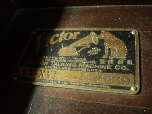

Joe -
Thanks for the reply. I have been going on the model and serial # the seller gave me. I looked closely at the model badge, again, and it is actually a XVI serial #190989.
I guess that makes it a slightly more desirable machine than the XIV?

Re: Victrola VV XIV
by Joe_DS » Mon Jan 04, 2010 12:39 am
repeal19th wrote:Joe -
I will post some pics tonight.
Thanks again!
Ed
I kind of figured it might be a model XVI. Desirability, among collectors, is more contingent on condition, finish/type of veneer, and originality. The XVI is a very common Victrola, but is, nonetheless, more towards the top of the line. According to the grid on victor-victrola.com, it would date from 1920. (SEE: http://www.victor-victrola.com/XVI.htm )

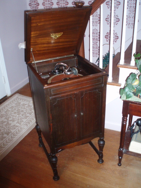

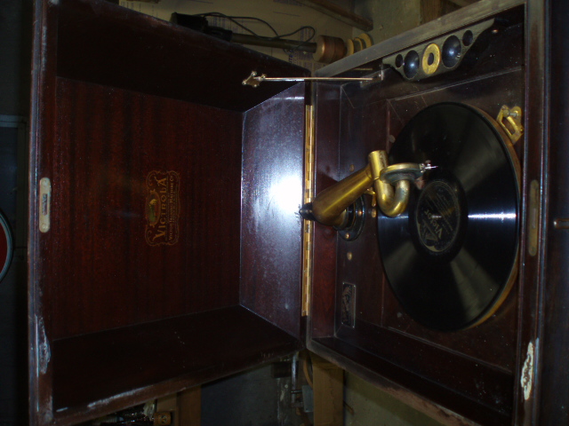

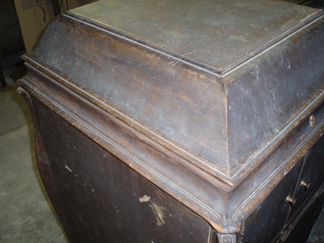

Here are some pics of my XVI. I am sure most collectors would not touch this machine with a ten foot pole due to the condition of the cabinet, but I am looking forward to seeing what I can do to revive it. The Veneer on one of the lower doors is basically toast.
Is the hardware actually gold plated or gold colored? Is there anyway to revive the plating where the hardware has tarnished?
I have yet to pull the motor out to see what that looks like.
Thanks for your comments and insight. This is a very informative board.

by Joe_DS » Tue Jan 05, 2010 7:56 am
Yes, that is, indeed, real gold plate. I believe it's 22 Kt., but don't quote me on that. Keep in mind these were SUPER expensive machines in their day. The original selling price of the VV-XVI was around $250 in 1920, or $2,000 to $3,000+ in today's money. Only in the later 1920s, after the introduction of the Orthophonic models (late 1925), did Victor use other plating on its standard production high end Victrolas--notably, antique bronze.
Whatever you do, don't attempt to polish the remaining gold finish. It comes off easily. I'd leave the tarnish as-is, for now. If the cabinet restoration is successful, you might want to make the investment in having the parts re-plated.
The finish on your Victrola's cabinet, btw, looks to be red mahogany. It may actually be easier, and much cheaper, to locate replacement doors from a similar junker cabinet (same model and production time-frame) than to locate the fine quarter-sawed mahogany veneers that would match the rest of the cabinet.
If I were in your position, I'd start by trying to learn as much as possible about the types of finish, stains, etc., used in the cabinet's construction. A good reference site, of course, is the Victor Victrola page, which provides detailed information about all of the Victor models -- http://www.victor-victrola.com/
Another great resource is a book, "The Compleat Talking Machine" by Eric Reiss. (That's the way "complete" is spelled in the title.) It walks you through most repairs, including cabinet work, motor overhaul, and sound box restoration. It's available from a number of well stocked booksellers, including -- http://www.amazon.com/Compleat-Talking- ... 1886606226 and is well worth the $20 investment.
This looks like it will be a challenging, but rewarding restoration project.

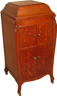

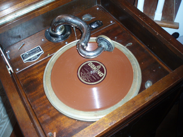

Here are pics of my (actually my wife's) first Victrola, a VV 4-3 Consolette. I bought it out of a garage-ish barn in CT for 50 bucks on Dec 12th as a Christmas present for my lovely wife. It was filthy, had paint spatters, and some minor veneer lifting. After copius amounts of lemon oil, steel wool and a little Liquid Gold wood polish the cabinet looks presentable. I did not take before pics, I should have.
The motor works but does need a thoughrough cleaning and re greasing of the springs. I did not think I could get that process done for Christmas, so I held that off for later. It plays well, and I have a good idea of its workings after tinkering with it.
Thanks again for your help!

by Joe_DS » Wed Jan 06, 2010 5:58 pm
Hi Ed:
Glad to hear you're ahead of the game. Yes, the Victor-Victrola page is probably the web's most comprehensive site devoted to a single manufacturer of phonographs (or talking machines, to be more exact.)
I love the Consolette (4-3). I had one, several years back, and it's the only Victrola I regret selling. As you know, it was the smallest upright model in the Orthophonic line, but with the exception of true bass, is a remarkable performer, especially when good condition electric-era recordings (from the mid to late 1920s) are played. For some records, you'd swear you're listening to an electrically amplified phonograph!
Being super nit-picky about sound quality, I went over the one I had, top to bottom, sealing all possible leaks in the tone chamber, especially at the base of the tonearm, and the tonearm crook, using heavy grease. I remember that this was discussed on this site awhile back and I provided the follow illustration showing where the grease should be applied:
I also had the sound box rebuilt and then, eventually, replaced with a better one. This really brought out the mid-range and treble.

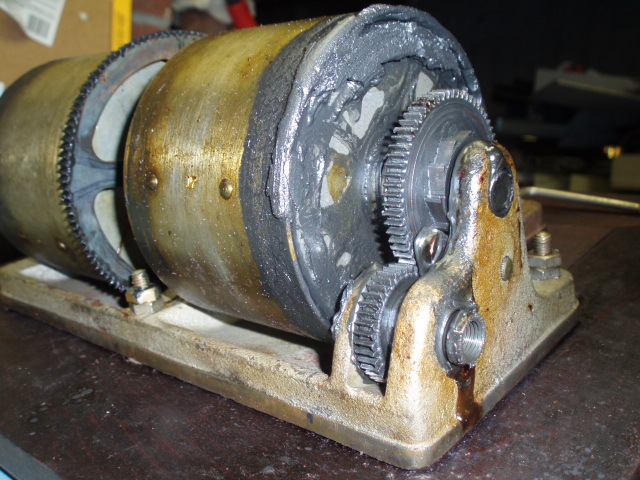

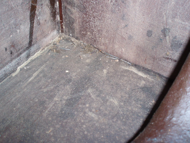

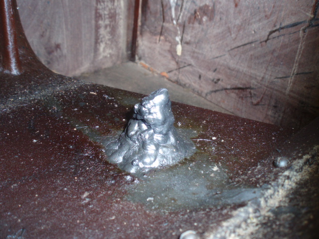

My "XIV", actually an XVI has been untouched since I deposited it into the basement two weeks ago. I decided to pull the motor to see what that looked like and here are some pics.....
z. Some old needles in the gunk inside the cabinet...Hmm, I wonder how many tungstones are in here....
Nice looking multispring motor that is absolutely caked in old grease....
001 ultimate ML 116.jpg (148.16 KiB) Viewed 7252 times
This is the stalagmite of grease on the horn that I found when I opened it up.
001 ultimate ML 114.jpg (150.51 KiB) Viewed 7252 times
Re: Victrola VV XIV
by Joe_DS » Thu Jan 14, 2010 6:43 am
It's pretty messy, but I've seen much worse. The motor looks to be in good condition, and should clean up very nicely.
Victor's four spring motor was great. It will run about 20+ minutes on a full wind. Once the springs are cleaned and re-packed, and all other parts cleaned & re-lubricated, it should run trouble-free for years. About the only thing you'll have to do is put a drop of oil on the governor friction pad every few months. (It's a good idea to wind it up and let it run down, at least once a week, when not in regular use. This keeps the grease distributed, and prevents it from settling in the barrels.)
The only thing to caution about is that the spring coils are razor sharp, and you have to be very careful when removing and reinstalling them. I've never tried this, myself; I've always sent the barrels to shops to be overhauled. But, I've known several do-it-yourselfers over the years who say it's no big deal.
