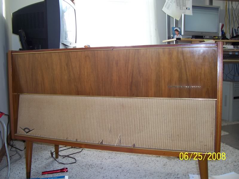

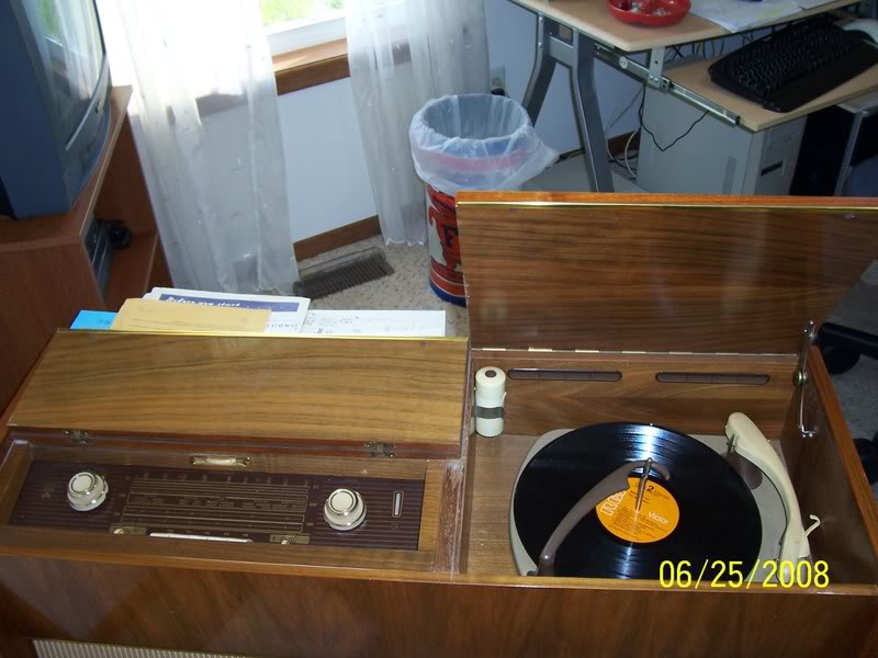

Does anybody know anythingabout this console. I inherited it and it was in my family since new in 1960 probably. Im trying to get it to work and have searched the internet and cant find anything on ths unit. Also can someone direct me to a troubleshooting page for these units ? it probably needs new tubes but I hate to buy all of them How can I test the tubes ? I remember when I was a kid we'd go into a drugstore and go to the tube tester LOL but I havent seen one of those in 40 years or more.

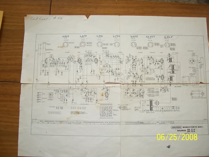

This radio has the following tubes. Next to them is what my dad wrote above them on the schematic

I dont see any tubes missing. One of my problems is I cant read a schematic so thats not helping. Im getting some speaker pop when I select the push buttons for FM,SW etc. but thats about it. I have the schematic and some pics if that will help you find the rectifier ? You might be able to see it if you save it and then open and use a zoom feature ?

I see a semiconductor rectifier in the schematic. It is either selenium or silicon.

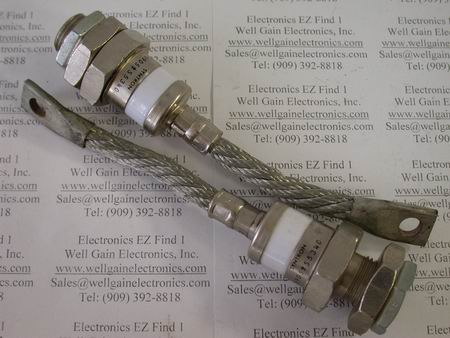

A silicon rectifier has several different looks, but is usually a metal cylinder with a flange on one end so it looks like a top hat. There should be a wire out of each end. High power ones have threaded studs to attach to a heat sink. Here is a typical older design for a high power diode.
Rectifier Diode.jpg (32.01 KiB) Viewed 15278 times
