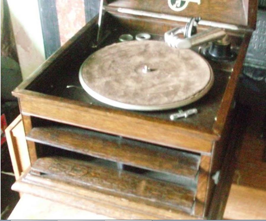

hi joe, ive managed to get the pic of the columba 117a onto the fb version of your forum, it looks abit dusty looking but im thinking its the camera i was using , ive since polished the cabinet and its looking swell, have to wait now untill the end of sept before the guy in booterstown returns from abroad

by Joe_DS » Mon Aug 24, 2015 2:20 am
Hi Maitiu:
I'm not a member of Facebook, but was able to view the photo. I've done a screen capture using my (Windows 7) Snipping Tool, and have downloaded it into this post --
Right Click and select "View Image" to see full image.
That's one of the Plano-Reflex Columbia Viva Tonal models, which were unique to the UK market. Note the flattened corners at all of the bends of the tonearm and horn. The theory was that sound would be "reflected" from the flattened areas in the same way that light waves are reflected from angled mirrors, resulting in an un-distorted sound wave or "beam of sound." In spite of the design's quasi-scientific premise, these were remarkably effective gramophones, from what I understand, and reproduced electrically recorded records with enhanced fidelity, compared to the older, pre-1925, models.
In addition to having the motor overhauled, if it hasn't been done, consider having the sound box (reproducer) rebuilt with fresh diaphragm gaskets, and carefully adjusted. This will greatly enhance the sound quality, and reduce record wear.
