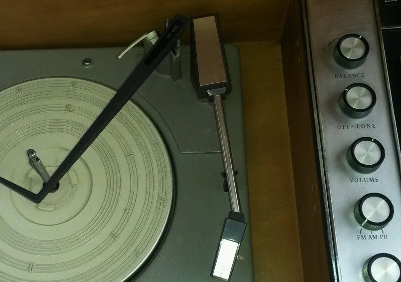

Oh, and if you get a second, could you please take a look at this picture and tell me what that white thing is behind the record changer arm? I have no idea what it could be, but it looks like it does not belong there.

by MattTech » Thu Jul 31, 2014 9:26 am
That "white thing" is a record size sensing finger, which through the mechanism underneath the changer tells the machine where to set the needle down.
In that photo it looks to be damaged or broken, and something like that is not repairable.
In some cases I'd retrofit another suitable changer entirely to make the console useable.
Go find another specimen, I'd steer clear of those damaged units.

by Thom » Thu Jul 31, 2014 11:50 am
Matt is correct. I have one of those sets waiting for restoration ( legs are missing from mine) and the one you are showing one is damaged. They are cute as as hell but the tone is somewhat mediocre. My advise is stay away from that one. At any rate you are better off finding one and restoring it or having it restored rather than buying one that is supposed to have been "restored".

by Ohiogal » Thu Jul 31, 2014 1:42 pm
Thom wrote:Matt is correct. I have one of those sets waiting for restoration ( legs are missing from mine) and the one you are showing one is damaged. They are cute as as hell but the tone is somewhat mediocre. My advise is stay away from that one. At any rate you are better off finding one and restoring it or having it restored rather than buying one that is supposed to have been "restored".
Well, to be fair, the seller didn't claim it had been restored, but I suspected that white thing was something to do with the record changer and that it was broken. Thanks for confirming my suspicions. I'll give this unit a pass and keep looking.

by Record-changer » Tue Aug 05, 2014 8:05 am
The record size sensor is not broken. I thought it looked funny when I first saw it on one of those I repaired many years ago. Its shaft is tilted on purpose. This lets the spindle be shorter without reducing the number of records it can hold.
