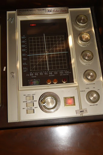

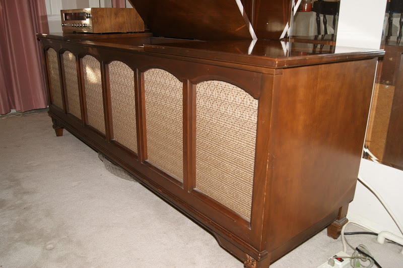

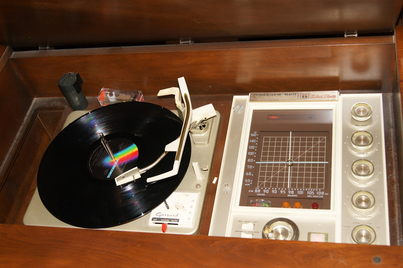

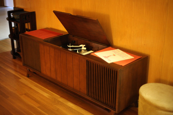

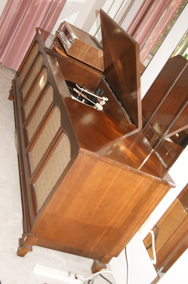

No problems to report, just posting pictures of my vintage stereo: a Packard-Bell RPC-39 Solid State console, made in 1966. I got it for $85 from a local seller on craigslist...it hadn't been used for 15 years by the time I looked at it, but everything worked right off the bat!
Packard-Bell RPC-39 console

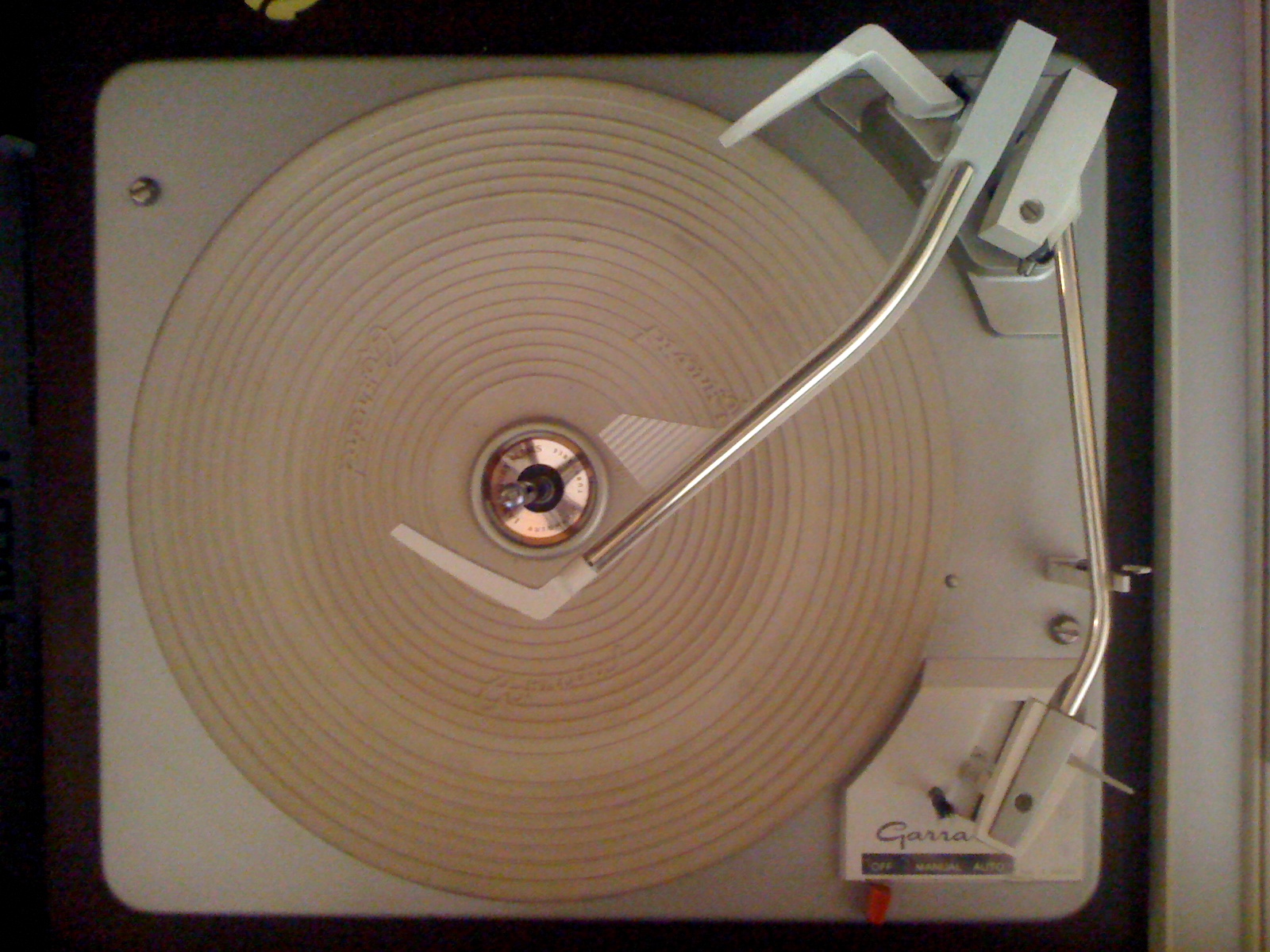

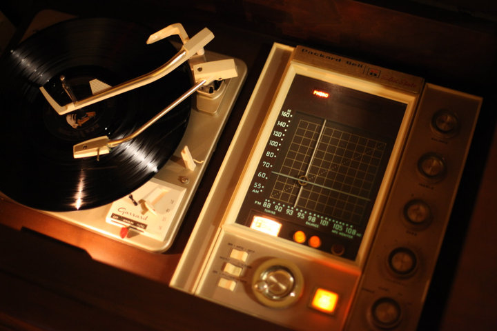

The turntable appears to be a Garrard AT-6, but looks different than all of the AT-6s i've seen online:
Detail of turntable and tuner
close-up of Garrard turntable
(607.33 KiB) Not downloaded yet
Since I got it, I've disassembled and re-greased the changer, ordered a replacement LRS-3 45 adapter and needle from voiceofmusic, and plan to replace the amplifier caps to improve the sound. Very happy with my purchase so far, I just love how it looks.

You did good, El Ramos...
My goodness, these kids don't know what they're missing with their MP3, IPods, etc. I think that this is a technology that many folks just won't let go, inspite of all the new media out there. Your unit is truly beautiful and what a magnificent piece of furniture, too. These beasts serve a dual purpose with their styling.
Some folks have long cabinets like those in their dining room...I forget the name, but I keep an Astro-Sonic under the big window near my kitchen table. It matches the table set/chairs and all the kitchen cabinets. --BB

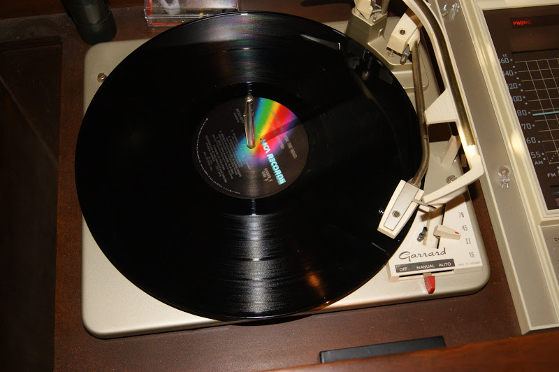

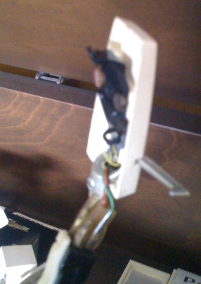

Okay, I think I do have a problem: the installed cartridge is wedged in at a severe downward angle because it's too long to snap into both the front and back clips on the tone arm. Which replacement cartridge(s) fit the clips on a Garrard AT-6 tonearm, and what needle would pair with it/them?
shedradios
Posts: 126
Re: Packard-Bell RPC-39 Solid State Stereo c. 1966
by shedradios » Tue Sep 21, 2010 4:53 pm
I can tell you a good one for sure...the Shure M3D cartridge with Shure N21D needle. It's expensive but that's relative.

Update: The clip appears to be an aftermarket piece...it's black plastic like the cartridge.
Maybe a picture would help:
Side view of Garrard tone arm with black plastic clip installed. Note "matching" cartridge hanging below.
It seems like I could remove the clip from the tone arm and install a modern cartridge having two screw mounts, like the Stanton 400 V3:
http://www.needledoctor.com/Stanton-400 ... tegory=381
I looked into the Shure M3D and M7D, but they are WAY beyond my price range. I just want an affordable cartridge that tracks reliably and sounds okay, which is probably all the original buyers of this stereo wanted, too. ;-)
by MattTech » Wed Sep 22, 2010 9:49 am
The picture is blurry, but if it is a magnetic cartridge, a 400V3 is a good choice.

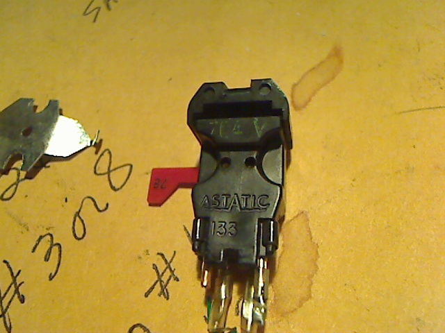

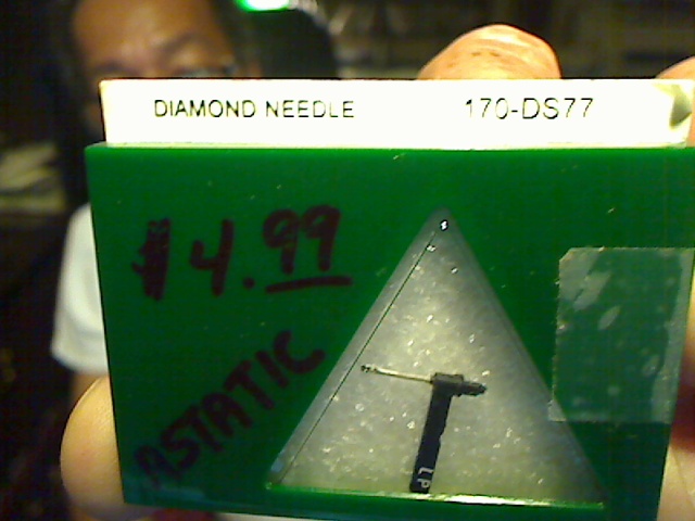

Get the number off your cartridge and read through the FAQ list near the top of this particular forum.

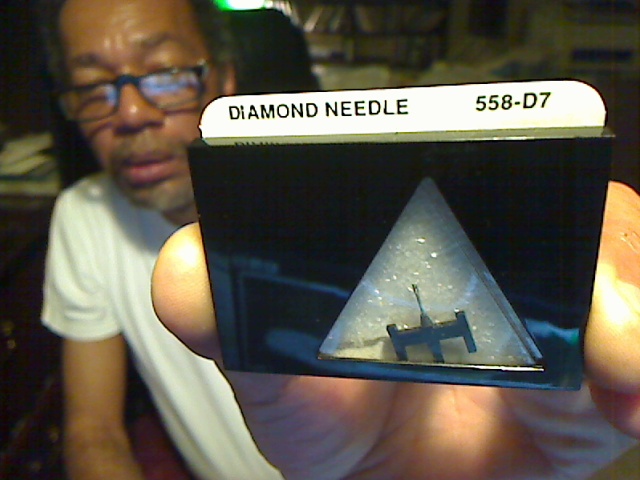

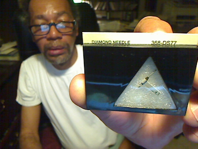

Just an example, you may have a cartridge with a stenciled Magnavox number 560345. The cartridge is actually an Electro-Voice EV275 or an Astatic 165D, and several needles may work. See below. --BB
Picture 8.jpg (95.99 KiB) Viewed 12277 times
Picture 9.jpg (89.27 KiB) Viewed 12277 times
Picture 10.jpg (83.67 KiB) Viewed 12277 times
Picture 11.jpg (91.76 KiB) Viewed 12277 times
Here is another example of a cartridge that came from a VM (Voice of Music) turntable:
An Astatic 133
Picture 32.jpg (95.88 KiB) Viewed 12254 times
