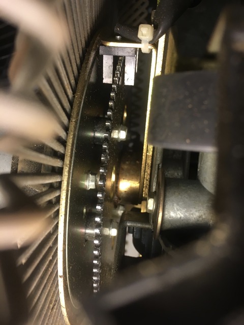

Basket slides inward on the post. It's hard to see in the photo above, but there is a gap between the two sets of gears on the motor. The magazine shifts inward far enough that its gear fits into that gap and thus the basket will not turn when the primary gear does. Here is a pic from another angle with the magazine pulled out where it should be. You can see how dirty the gears are. Would LOVE to get the magazine off of there to clean everything.
However, I am reluctant to remove the basket because of how the opti switch is connected to it. (see photo below). I am concerned that I will not be able to get it back in the correct location or that I will damage something in the process. With that said, If the gears are that dirty, my guess is that the opti switch needs a good cleaning as well.

Ron, you say that the opto is "simple" to remove and replace. I must be dense as I cannot figure out how to do so. Access to all the screws holding it in place are blocked, either by the Magazine or the plate that the opto is bolted onto. My manual has info about recalibrating the opto, but NOTHING about how to access it for removal and cleaning. If you can lead me through this I would be forever thankful.
If you look at the photo above, the opto prevents the Magazine gear (which is screwed to the magazine hub) from being pull away from the motor. The only way that I can see to separate the opto from this gear would be to remove those hex screws that hold it in place. However, this is not possible due to the fact that the spokes of the magazine block access to these screws. So what I am missing here?

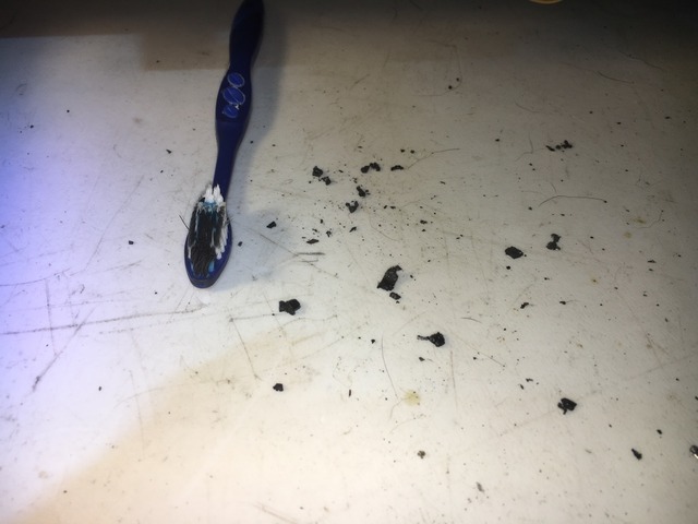

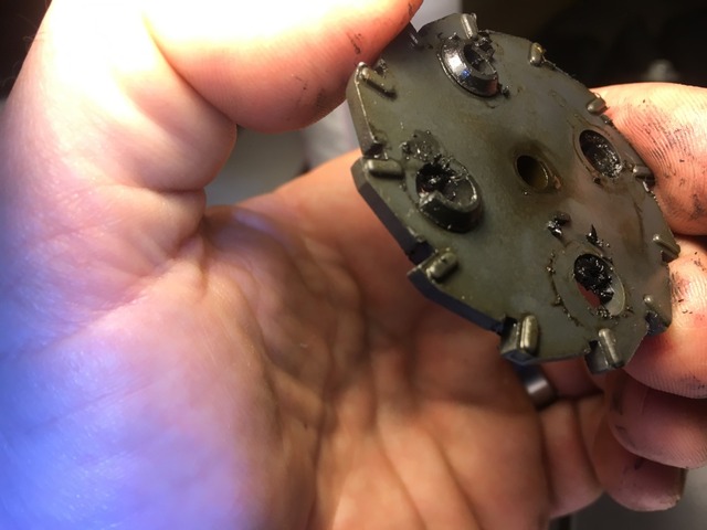

OK so more interesting discoveries. What I though was grease was actually part of the sprague wheel hub (what I was previously referring to as the "gear") that had actually dissentegrated into goo.
I can't find a proper full picture of this part, but pretty sure that it is not supposed to have this slot (worn into it by the gear on the magazine I presume).
It's a bit difficult to see, but there was actually viscous plastic remnants left embedded around the pins on the stem bushing.
Here's a pic of the back side of the spraque wheel and you can see where most of the four collars that surround the pins on stem bushing are gone.
those black pieces and the discoloration on the toothbrush are what is left of those collars.
So I guess it's time to order some spare parts. Anything else I should replace while I have this thing in pieces?

Re: New to Jukes - Working on a Rowe R91
by Ron Rich » Thu Apr 07, 2016 12:44 am
Hi Duane,
That's not "plastic" that you see--that is actually rubber--yep, order the whole "gear and hub assembly". It will come with 4 new rubber grommets, all assembled. Remove all traces of "lubricant" anywhere near that gear/shaft--the put ONE drop of 20 wt. ND oil, on both ends of the gear shaft--and oil the armature shaft on both ends with the same oil ( SOME motors have oil wick holes for the armature shaft ends-some do not). While you mech is out of the cabinet, you should also oil the transfer (gripper) MOTOR. It has HUGE oil wicks that should be filled with 20wt--just do not over fill them, or you WILL have oil on the records ! Do NOT--ever/never, oil or lube the gripper itself in any way !! Ron Rich
