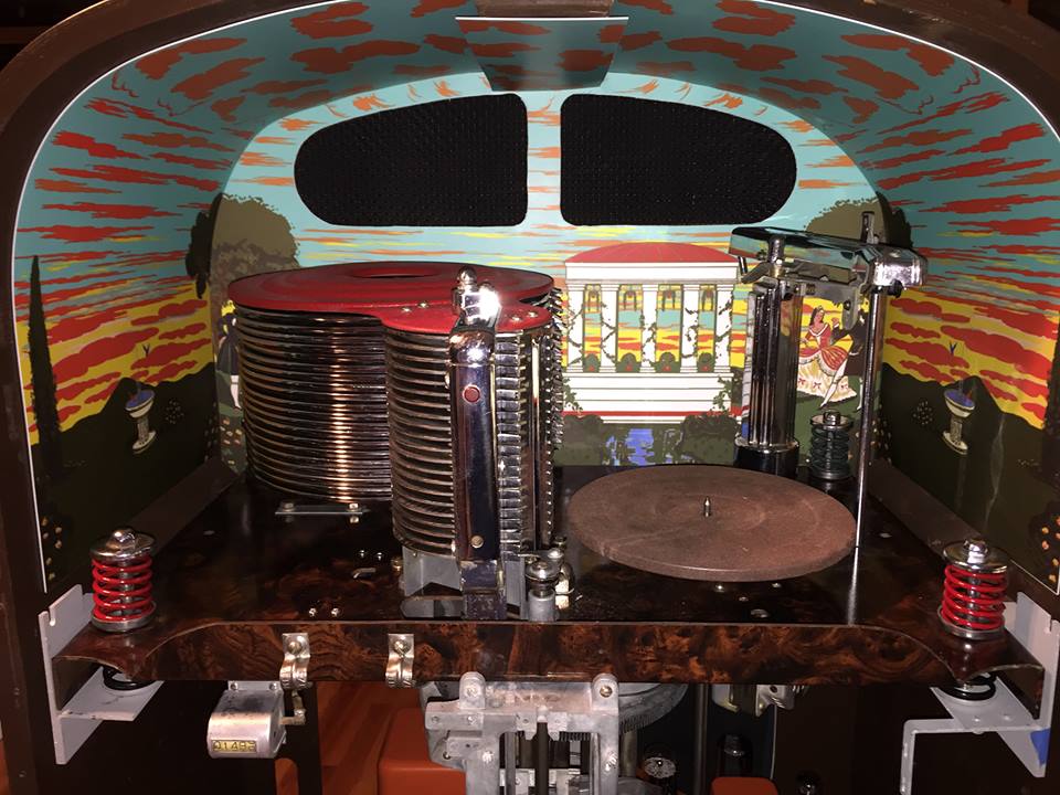

You have to pull the mechanism to remove the record stack, The shaft will hit the top of the cabinet before it comes all the way out. Then you have the comb on the back and 3 bolts on the bottom. Once out, you will see that the record holders have spacers that they are pressed into and are very difficult to remove and replace without damage. Then after you replace the broken tray, you have to get it all lined back up, pressed back together and get shaft aligned. I would pull the mechanism far enough forward to clear and loosen the two screws that lock the shaft underneath the base. Pull the shaft and take the three bolts out and pull the whole record stack. You can find these stacks for not a great amount of money. Great time to repaint the top plate and polish everything. I make reproduction backgrounds if you want to do that while you have mechanism out or pulled forward.
1422 background.jpg (110.32 KiB) Viewed 3788 times
