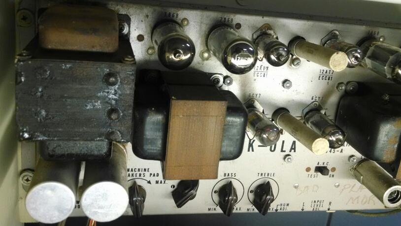

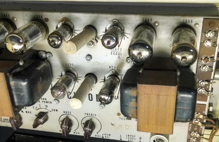

by ed22 » Sat Jun 27, 2015 6:05 am
Here are some pics of the amp while installed. I think everything is plugged in properly, except for a wire that has been severed from the low bass unit above the credit unit. Also, the terminals on the right have some wires attached but go to no speakers that I'm aware of. maybe you guys could let me know.

Re: amplifier issues
by Ron Rich » Sat Jun 27, 2015 5:48 pm
Hi Ed,
Phono make/model number would help --- amp model number would help--but, most of all--do you have a Service Manual--it should answer all of your questions-- Ron Rich
