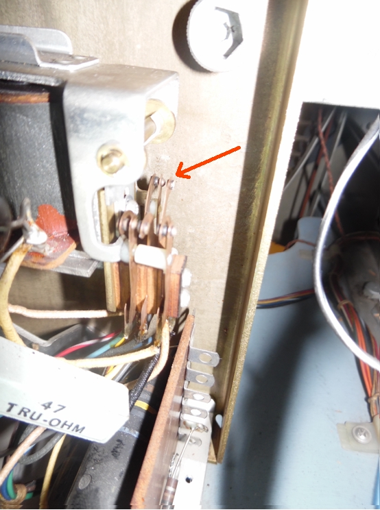

the capacitor i bought 100UF 50V didnt solve the problem
the original one was tested with cap meter to be ok
matt you are probably right, amateurs are the problem not capacitor
but this machine has not played for 30 years and I have to solve it ...
the DC current measured at the inlet to the cap is 24V DC, i think its ok ? right
any clue what else can be checked ?
this is the selection solenoid to working
Eitan

JukeIL
Posts: 48
Joined: Sun Jan 24, 2016 12:18 am
Location: Israel
Re: Help appreciated - conti 1
by JukeIL » Tue Feb 02, 2016 12:11 am
OK!
I hope this post will help others:
If your AMI continental just spins, or does not spin (the microswitch just stopped it) and you make a selection but nothing happens - aside the selector wheels (on the front) spins and stops (your hear cancel click) i.e. you hear a click but the little hammers on the back wont move so:
1. either your capacitor might be faulty (the little can shaped one near the right selector wheel - see pic in the first page) - its a 100UF 50V (yes the modern ones are 10 times smaller...) - or (more likely)
2. you better clean the contacts of the upper relay
see pics below
now what is the best way to clean them with out the need to buy special materials ?
(this helped me https://www.youtube.com/watch?v=RShctrxBPyM)
eitan
by ami-man » Tue Feb 02, 2016 1:20 pm
Hello Eitan,
I always use a paper taper (you can buy paper cleaning strips) for cleaning the tips of contacts.
The contact on the left of your picture however has seen a lot of heat by the looks of it so the contact tip more than likely will be pitted, so may need replacement. This is where all those old saved contacts come into their own.
