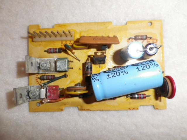

Clones,
Looking at it, my guess would be, it is the driver stage--looks like it has three transistors, and an adjusting pot (for the bias?). "Heat sunk" to a "driver transistor" (?) is a (dual ?) diode ? Un silk-screened, so I don't know what goes where--caps maybe incorrect--very suspicious of one that is larger then space allowed ?? Ron Rich

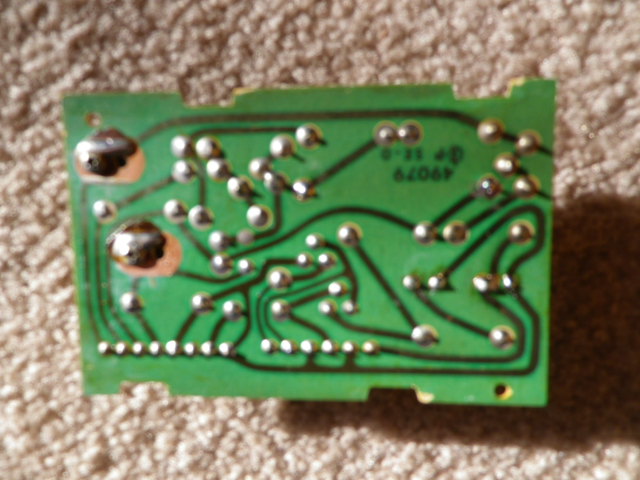

ds100h
Posts: 678
Location: Clinton, Ia USA
Re: Rockola 464 Amp
by ds100h » Wed Jan 15, 2014 5:45 pm
Clones
This is the other driver board, which checks good. The part # is the same as the bad board.
Ron
As the large blue cap on the good board is in the same location I do not think there is a problem there.
Best
Darrell
Good Board Same Part #49079

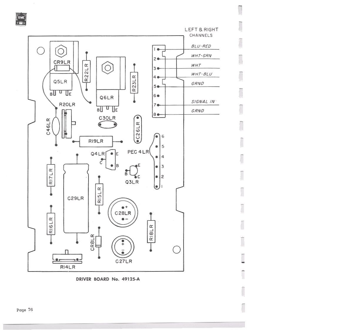

clones
Posts: 582
Re: Rockola 464 Amp
by clones » Wed Jan 15, 2014 6:17 pm
I have attached the schematic for the rockola 49125-A driver pcb, looks the same at the one in your photos, i have a few driver boards of this type at home i will photograph and post later

ds100h
Posts: 678
Re: Rockola 464 Amp
by ds100h » Wed Jan 15, 2014 8:44 pm
Clones
Thank you, that is the same schematic I have. Just not sure if it applies to part #49079?
Appreciate your help.
Best
Darrell

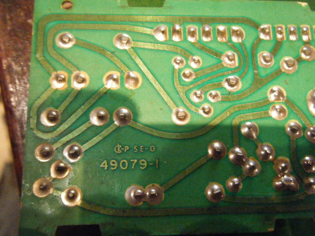

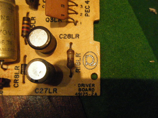

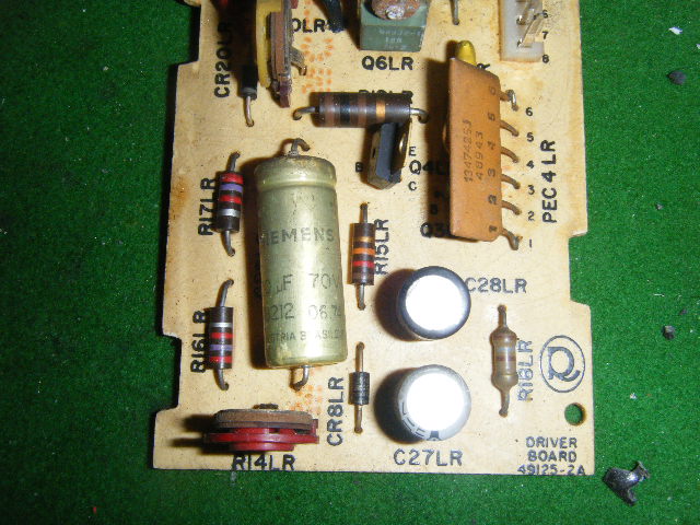

by clones » Thu Jan 16, 2014 12:31 am
I took a few photos of the spare driver boards I have and they are numbered at the front as 49125 and at the back as 49079-1, so the driver baord you have is the same as the schematic
regards
clones

by ds100h » Thu Jan 16, 2014 2:20 am
Clones
Thank you. I see that my boards are 49079 and yours are 49079-1, is this becuse they made a minor change to the board and yours are a different production run?
Also, I see on yours the individual components are clearly identified, whereas on mine the parts are not identified, could that expain the part number change?
Also I do not see the 49125 part # on my boards, just the 49079 on the reverse side?
Best
Darrell
