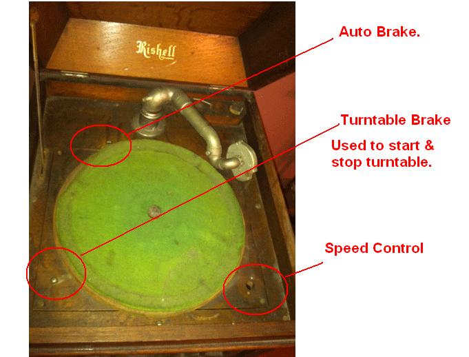

Wonderful news... after pulling the unit apart, we found more pieces of the puzzle. Almost the entire arm is there now, except for the front part of the needle housing. The motor is still there but the spring box is missing. The only other parts that I see as missing are the crank and the turntable stop plunger button.

That's a good idea to send the motor out. Now that I know what I need, it shouldn't be too difficult a job, just need to find everything. Can't wait to hear this thing play. I vaguely remember it a long, long time ago, maybe in the 70s, that nostalgic scratchy, far away sound. Can't wait to hear it again.
I do have some questions though. If you look at the bottom picture, the hole to the bottom right of the turntable I am assuming is for some kind of start/stop button as that's what the mechanism underneath does. Am I correct? What kind of part do I need for that?
Also, to the top and bottom left of the turntable, there are levers, no idea what for. Speed control maybe?
And lastly (for now at least) when you remove the tone arm, there is some kind of spring or something in there, not sure what it does or what its for. Its not spiral but a thin piece of wire with a loop at the top. Any ideas?
Will keep you posted on the progress and thanks again for the help!

by Joe_DS » Thu Nov 17, 2011 11:49 pm
Hi Vikki:
The controls are as follows --
The "hole" would have probably held the knob to adjust the speed. When shipping the motor to the shop, it would probably be a good idea to ship the motor attached to the motor board. In that way, all of the replaced missing parts will be correctly installed to work with the motor.
