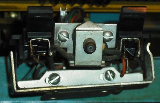

Thanks for the "heads up" but I'm a little confused now. The black contact block assembly (frog) sits in the drive bracket (the holder with the spring). The drive bracket is attached to the contact arm on the carriage assembly, and runs under the frame. I attached a picture of my situation.
It appears that the holder (not the contact arm) is bent down to the left and the spring is not contacting the block assembly. I can't tell if the contact arm that supports the holder is also bent but I don't think so. Is it the contact arm that you are referring to in your last post, or is it the holder? Should I straighten the holder so it is parallel to the selector assembly track?

Re: m100c plays same record over
by Ron Rich » Wed Mar 21, 2012 5:59 pm
Hi Steve,
That's a classic case of the problem encountered by not properly bolting the mech for transport !
You need to do what ever it takes to return the "U" holder (aka "bracket"), so that both ends of the "U" are high enough to support the frog.
In other words--the "tips" of the "U" should be no further then about 1/4 inch from the bottom of the frog.
Replacement coils are available from Vern Tisdale http://www.verntisdale.com Also, if you want NOS coils, check with Bob Putnak <sales@tubesound.com>; He MAY still have some--
Note: If you are 'burning coils", check fuse size--it's the "outboard" one and should NEVER be larger then 1.6, even if the paper label calls for a 2amp !
