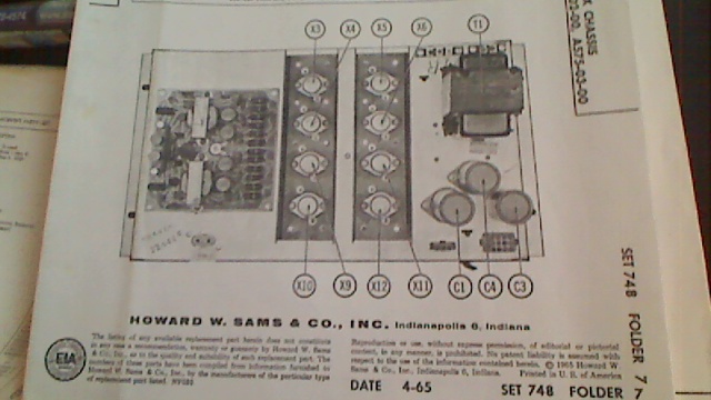

by Mowgli » Wed Mar 23, 2011 8:51 pm
He has the tuner/preamp working better than it did from the factory yay.
The bleeding balance is actually in the amp # a57502
Anyone have the manual with schematics etc?

by Mowgli » Tue Apr 12, 2011 1:43 am
No help at Magnavox Friends, they had ideas but not relevent.
The amps are seperate left and right.
What actually shares left and right on the amp?
That's the only place(s) it could be bleeding from channel to channel.
