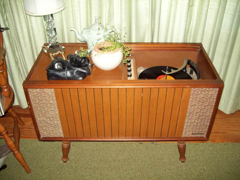

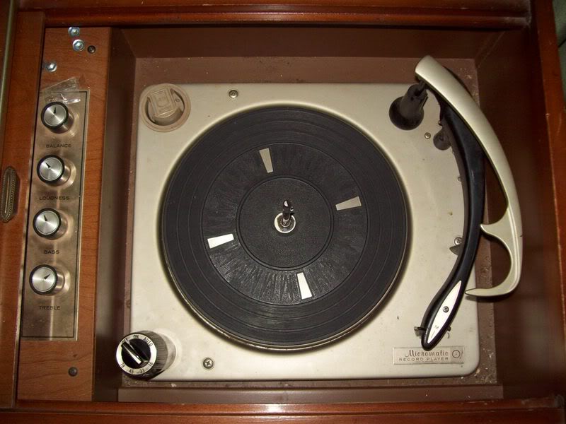

Guest
Photos -- If it will help
by Guest » Sat Feb 16, 2008 7:43 pm
-- Image
Re: question about magnavox micromatic console needle/cartridge
by Record-changer » Sat Feb 16, 2008 10:07 pm
That was made sometime in the period from 1963 through 1966.
by shedradios » Sun Feb 17, 2008 7:01 am
Hi guest,
Nice looking Magnavox. The reference number 6541 indicates changer is dated 1965. I have three S600 changers and they are similiar to one in your picture, in fact looks to be same. Two are from 1962/63 tube sets and one from 1965 solid state set. All of mine use an Electro-Voice cartridge 132. Do you have the number of your cartridge?
Ebay is a good source to look for needles and cartridges. Also, you gain from the seller's source data in that you get replacement and substitute information. If you think they are too high, use their data to search the web for other suppliers. But any of the big cartridge/needle sellers on ebay are helpful and in most cases you can't beat them.
Is your set tube type or solid state? I guess you know for sure your problem is the cartridge.
by Bobby Basham » Sat Sep 05, 2009 2:49 am
FOLKS...
Lift up the tone arm and, when looking at the front of the cartridge, so you a square metal clip, pull that with your thumbnail or small screwdriver slightly forward and the whole cartridge will pop downward and right out. The cartridge number should be on top. That's how you match a PARTICULAR cartridge to the correct needle. To put back in, slide the back of the cartridge into the mounting bracket first,then push up on the front part until it snaps back into place.
Model/Run numbers, cabinet finishes, etc., have nothing to do with the cartridge and its appropriate companion. Those older turntables could use many different cartridges provided that they had mounting brackets that would fit and also have the same output voltage.
I have four consoles with the same turntable, and all the cartridges are different. One tube model, I believe, has a flip-under crystal, where the whole cartridge rotates in its own mount.
Those W610 series micromatics were basically the same, the only difference being a smaller or larger platter (interchangeable), a taller or shorter spindle, black/gold or black/silver tonearm with matching overarm thingy, and different molex connectors underneath to connect to the receiver/amp. If it was used as a separate unit in a component system, it would have had a short speed on/off speed selector switch. Just my two cents. --BB
Sorry if I tend to be verbose and over-explain things. Just trying to help out the newbies.
by Record-changer » Wed Sep 16, 2009 1:44 am
The cartridge does NOT pop out on the ones that have two screws on top. Instead, remove the screws. They look like the one in my avatar.
I was imagining someone breaking the cartridge mount on these trying to pop the cartridge out.
Last edited by Record-changer on Sun Sep 20, 2009 6:15 am, edited 1 time in total.
by Bobby Basham » Wed Sep 16, 2009 6:28 am
Sorry, Record-changer:
I was referring to the ones that had the single screw through the top of the tonearm that held the mounting bracket in place. You can remove those cartridges without disturbing the mounting bracket. --BB
