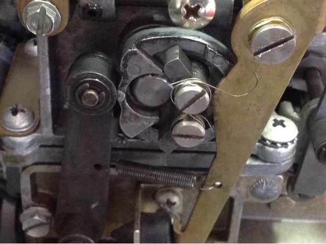

Had the mech cycling left and right on the bench and it intermittently transferred a record to the turntable and returned it to the rack without playing it, it's not the clutch binding as I've had this apart oiled it then oiled it again and then decided to oil it a bit more. (Ron I did read your book :D )
I'll work my way through the issues but noticed at the end off the day the pawl springs on the brake cam have been destroyed? Any advice on why how would be appreciated as they were fine originally.
Re: Seeburg 222 restoration
by Ron Rich » Thu Sep 22, 2016 3:41 pm
It would be my GUESS, that something you used tangled with the lower spring somehow, dis lodging the upper one slightly, then continuing to further impact the lower one ??--Doubt I have ever changed more the 10 of them--but have seen a few "messed up"-- Ron Rich

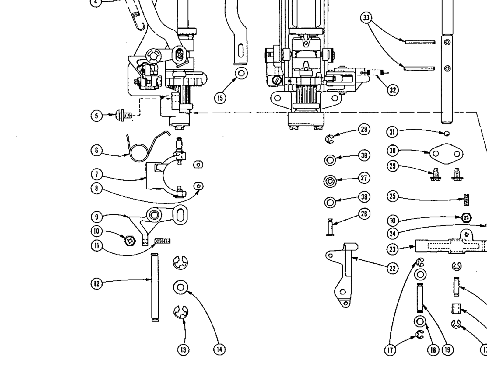

It appears to me, that ALL your remaining problems are "clutch related". When you removed the clutch assembly, did you check the longer pin attached to the yoke ? It sounds as if it is not tightly attached to the yoke (zero "play" allowed !!) ? Did you re-adjust the clutches--1 thru 4 in that order , BEFORE, proper oiling ? Did you use 20 wt. oil ? Ron Rich
Faza1
Posts: 53
Location: Sydney, Australia
by Faza1 » Thu Sep 29, 2016 4:15 pm
Ron,
Excuse my ignorance but are you talking about item 12 in the attached drawing?
I haven't made any adjustments to the clutch yet, as it seemed to be working I left it alone.
Are you suggesting I perform the clutch adjustments 1 to 4?
(378.21 KiB) Not downloaded yet
by Ron Rich » Thu Sep 29, 2016 5:51 pm
Hi John,
No--item 12 is the pin the yoke rides on ( which also MUST be "free")--I am suggesting the larger (upper in the drawing) pin that is attached to item 7, the yoke itself, may have worked itself loose, due to previous lack of lubrication, and the resulting strain.
Yes, to adjusting the clutches as shown in the manual, IF, it still favors one side of the record slot. Ron Rich
