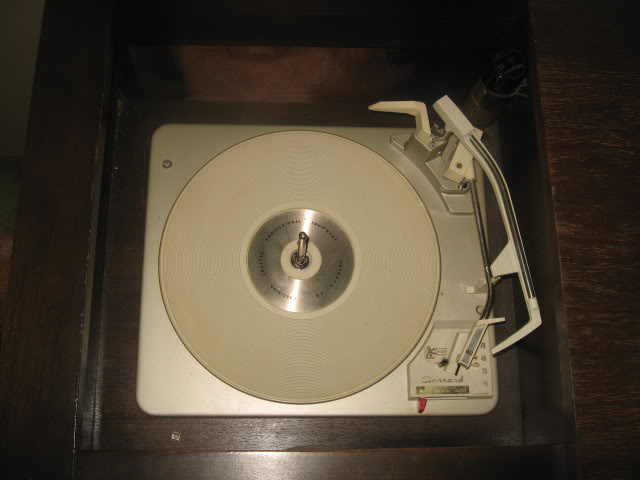

Judging from the changer's styling, it's a Garrard 3000 series with a Pickering magnetic cartridge - popular in the early-mid-60's.
The model number is usually located on a sticker or stamp on the rear of consoles.

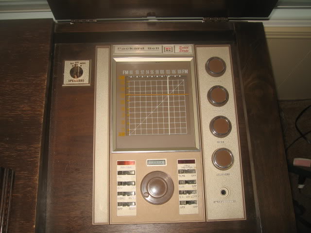

Check your speaker switch. Yours appears to be on EXT (external speakers), you need it to be on INT (internal speakers) to get sound out of it unless you have external speakers connected. Try this first. Both setting has both internal and external speakers playing.
