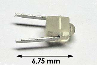

Thanks for the advice.... Got the FREE play working with a rear switch connected so it can be turned on or off, found some new/old stock IR LEDS and replaced all IR in the coin-unit and the one on the carriage tracking wheel... there's one IR transistor receiver missing from the coin-unit, display still shows ERR-C and I suspect its the missing IR transistor... Will try id and replace it...

However it's IR receivers that's needed for the coin counter...still looking to ID those little guys...
