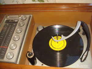

Here is the changer shown at the beginning of the thread. It is clearly not the older, curved-arm M Series changers you are referring to, but the W Series:
FreeLantz wrote:Photos to follow:
Gerry
Baltimore, MD
gerryu21220@gmail.com

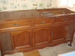

So Bobby, did the 72" look like this?
I'm driving 70 miles round trip to Scummerville (Too near Boston) for this one ($40 - CL, I'll haggle).

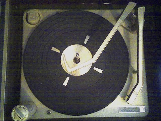

by Mowgli » Wed Sep 29, 2010 11:02 am
I got it for $20 - she really wanted it gone :D
It had some issues there that partially resolved with some mad-scientist knob twiddling and frowning interspersed with some "I don't knows".
What a beast, it weighs about 7500 lbs and I had to lay it down in the back of my HHR. All the others fit standing up.
It's 59" long and yes, it has a seperate amp.
The tag says 120 watts W00T!
Big honking magnets on the 15" Woofs and I have extra (matching model #) Horns from another box if I ever need them.
June of 1965 and model #3ST686
I squirted some contact cleaner where I could reach and got the controls fairly smooth.
This one's a keeper if I can resolve a couple of issues.
The tuner needs a restring. How many $$ should that run me? (My hands can't do delicate work anymore.)
It plays @ about 30 RPMs insted of 33. about 67 seconds for 33 1/3 revs.
Imaginary Lover by ARS never sounded so layed back.
Is there a simple adjustment for RPMs or is it more involved than that?
The bigger issue is the tweet doesn't sound right on one side.
I swapped the leads and now the tweet on the other side doesn't sound right.
Could the crossover be shot?
It's like that whether tuner or slowpoke TT are selected.
I guess I could try swapping the leads at the crossovers to see if it's the (R side) output or the (R side) crossover.
That sound like my logical next step?
Thanks for the advice.
