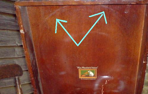

by listner » Tue Feb 24, 2009 10:44 pm
Much obliged for your assistance Joe, I really have no idea how to work this thing.
Hopefully the pics will allow a positive identification.
It took me awhile to get the hang of all this html stuff too.
In any event, here ya' go:

Re: HMV 102
by STEVE » Thu Feb 26, 2009 6:47 pm
Yep, exactly what I said.

Re: HMV 102
by listner » Fri Feb 27, 2009 7:33 pm
Thanks for that, mystery solved. Amazing what turns up in junk shops. Any idea whether it
would have had a record tray, I'm guessing the motorboard was a stock part pre-drilled so the pegs were fitted, but would a tray stay in place or the records stay in it without the pad in the lid?
Re: HMV 102
by Joe_DS » Fri Feb 27, 2009 8:19 pm
I'm not sure if this is caused by the camera, itself, but looking carefully at the photo of the lid's interior, I see a (dull) semicircle impression.
HMV Lid.JPG (24.15 KiB) Viewed 3810 times
It could not have been caused by contact with the rim of the turntable, since the tone arm, as well as the turntable spindle, protrudes well above the rim. This leads me to believe that a record carriage may been sold with this machine.

Re: HMV 102
by STEVE » Sat Feb 28, 2009 2:25 am
As far as I'm aware record trays were never sold with these particular 102's. Not all British 102's had the tray and the Indian models were even more unpredictable.
Is that semi-circular white line not just a reflection of the edge of the chrome turntable in the lid?
If you look at the whole of the lid internally, you can also see the tone-arm reflection in it.
Re: HMV 102
by Joe_DS » Sat Feb 28, 2009 5:09 am
STEVE wrote:As far as I'm aware record trays were never sold with these particular 102's. Not all British 102's had the tray and the Indian models were even more unpredictable.
Hi Steve:
On second glance, I think you're right. I can actually see a double reflection of the turntable now--a smaller one in the center, and then a larger one.

Re: HMV 102
by listner » Mon Mar 02, 2009 12:35 am
The white line is a reflection,no tell tale marks in the lid.
