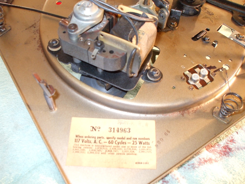

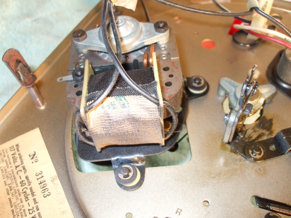

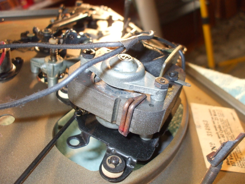

Finally found time to post pic's of r/c. after posting pic's I'm going to remove motor from r/c base and I'm sure I'll have more question's

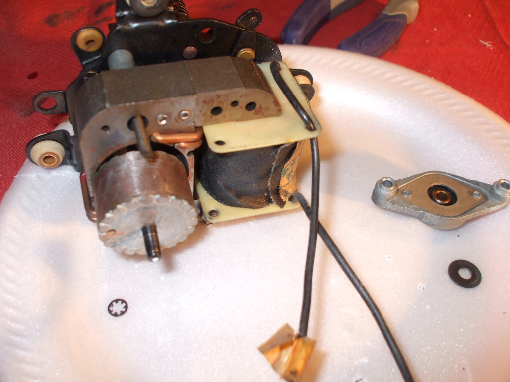

o.k. I've removed the motor now how do I disassemble??

Matt, that's not what I was after....would I be correct in removing the 2 nuts on the diamond shaped thing....I have never opened one of these up and have no idea what's inside other than very old oil...I have a full set of sockets.

opened what I guess is the bottom bearings and no oil? see photo.
Re: truetone r\changer slow cold start, but fine warm?
by MattTech » Thu Apr 07, 2011 5:55 am
Ya take that bottom bearing, the top bearing with rotor, and soak it overnight in thinner.
Next day dry it all out and soak the bearing felts with light oil.

Was / is there a steel ball in the center of that shaft--it appears so from the pix ? If so, it should be removed, and the hole cleaned, and re-lubed before you reassemble the motor. Ron Rich
by MattTech » Thu Apr 07, 2011 7:13 pm
Ron Rich wrote:Deash,

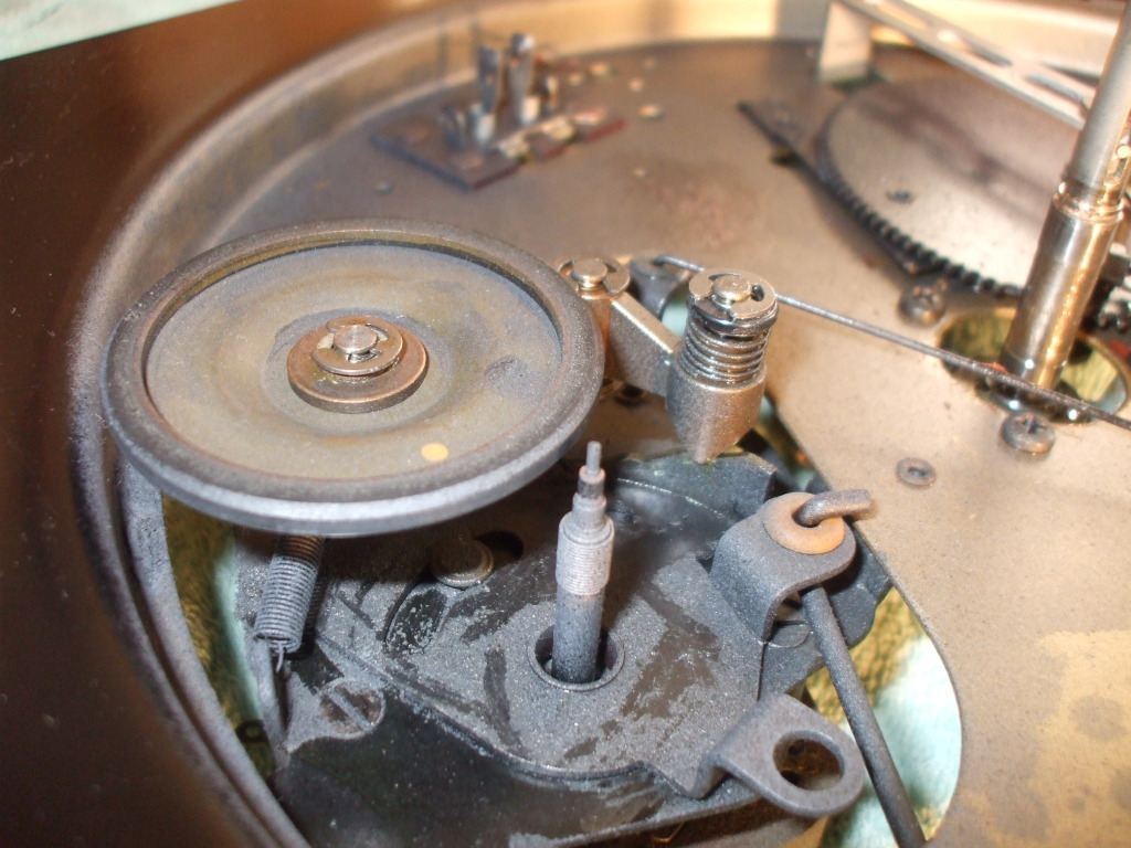

No Ron, those V-M style motors (It's actually a Voice-of-Music record changer) have a rounded tip on the lower shaft that rides on a tempered steel plate inside the bearing cup.
A good soaking in thinner to clear the old lube out is needed on these motors.
Once re-assembled and re-oiled, a slight tap on the shaft to center the bearings is needed.
The upper shaft has a spring wound on it for the 78 speed, (see photos) so it can't be easily removed from the upper bearing..... I just soak the bearing & rotor as a unit.
