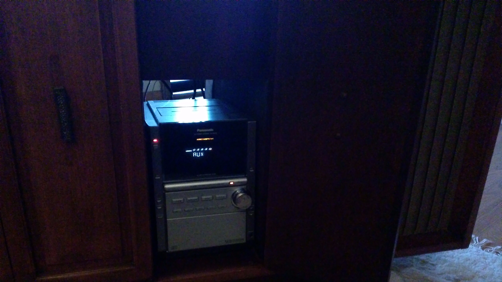

(779.64 KiB) Not downloaded yet
1st post any i just did that to my 67 hsc while the amp/tuner is in the shop. I'm so impressed with the sound and the fact It plays cds and a cassette AND a remote and fits perfectly in the album storage bin. It will live there for good and if the orig equipment is a tough nut to fix I may put it back and let the dial lite up just for pretty.
Its a Panasonic Sa-pm18 14.00 goodwill special. Not sure my image will post.
Cheers
Alan in mesa az
