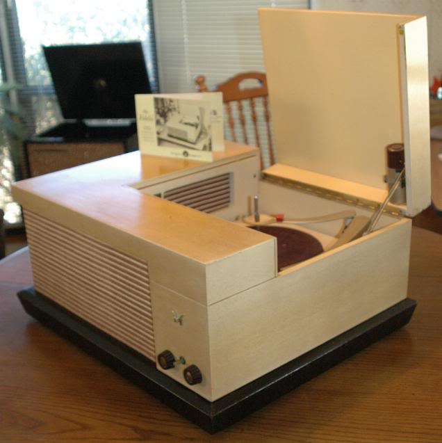

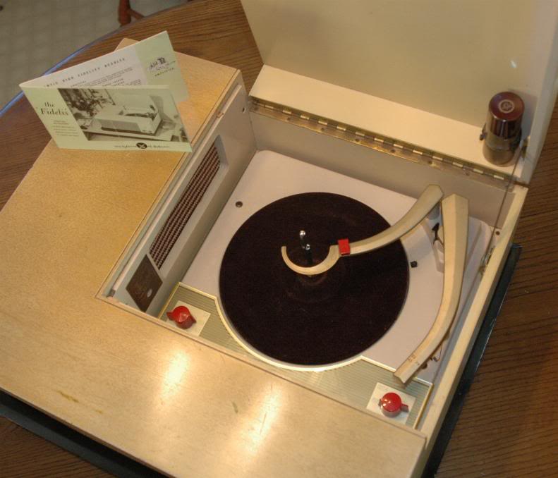

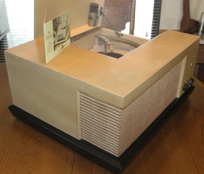

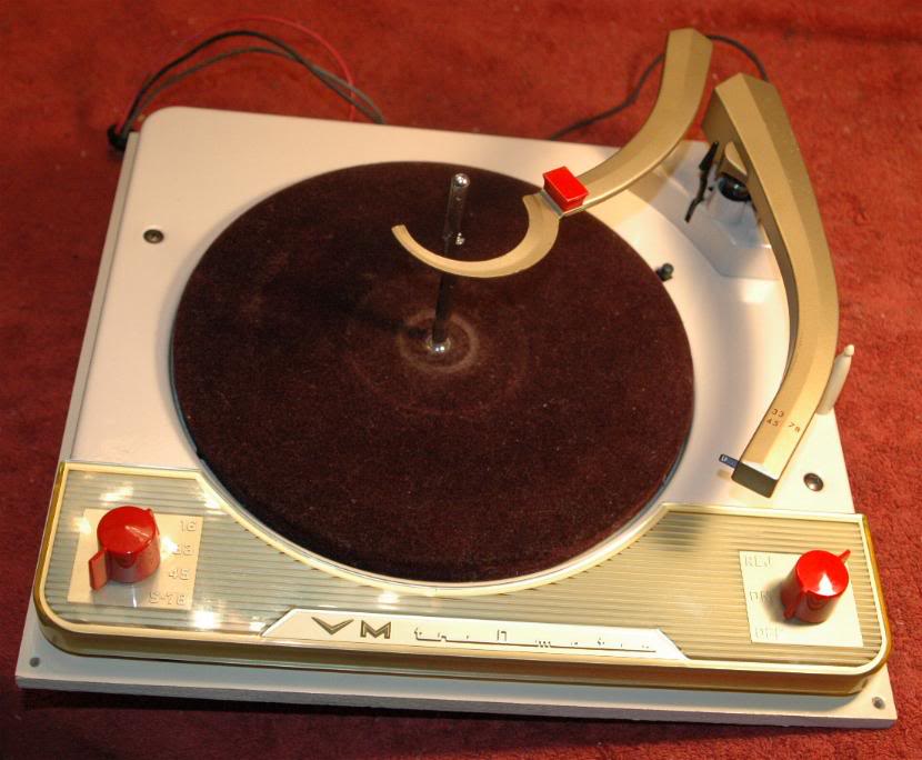

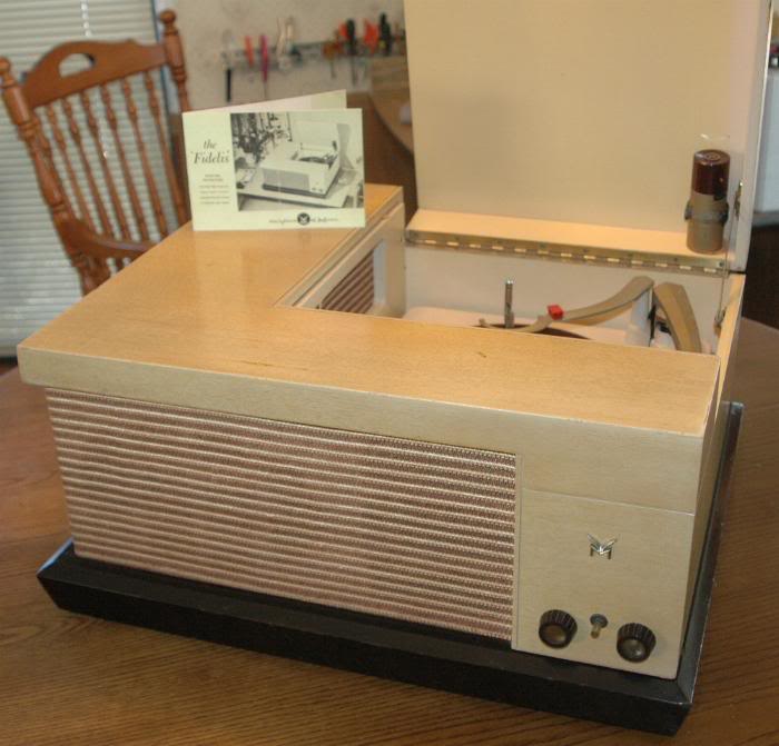

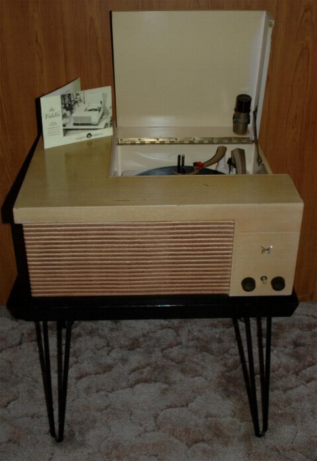

I recently acquired this very nice 1956 Voice of Music 560-A which is called the "Fidelis." You wouldn't believe this player. It has a console sized amp with push-pull 6V6s, a 6x9 inch woofer and two 5x7 tweeters, one of which is mounted on a wooden angled baffle. The cabinet is sealed and is a bass reflex enclosure... everything has to come out through the changer compartment for service. There is even a brace in there that has to be removed before you can get the amp out. I recapped it and fully serviced the VM-1200 changer, and I can tell you this player puts out a sound comparable to a console. One nice feature is a lucite lazy lite rod on the front that when you push in half way, it turns the unit on; and, when you push it all the way in, it rejects the record. I added an idler modification retraction kit from Gary Stork of VM Enthusiasts, which pulls the idler away from the turrets and platter when the unit shuts off. I also added wrought iron hairpin legs. This set is a real beauty, and sounds absolutely wonderful.
