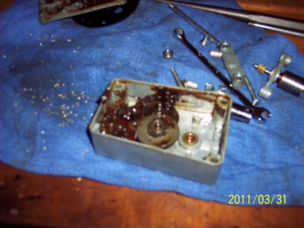

When I took mine apart it looked like this: Image
The small brass gear was mostly stripped. I didn't have any problems realigning when I put it back together though.. At first it actually moved the write-in arm but of course got to the stripped part of that brass gear and bound up. But if I can potentially get a new gear or have it rebuilt that would be fantastic.
I tell you though Derail, Ron is the man when it comes to this stuff. And jukeboxparts and needles4jukeboxes are the best places for parts/etc.

Curtis, that's about what my motor looked like. I was able to get all of the old grease out and renew it. I think the problem with the motor is that I had the two screws that secure the stator(?), torqued down too much. Loosening these and greasing the write in track solved the issues.

How easy would you say it should be to spin a "healthy" write-in motor/gearbox?
I have one on the bench right now and am debating opening it up and cleaning it out. Judging by the rest of the unit, I'm sure it looks like the pics above if not worse.
With the unit mounted I can spin the write-in arm fairly easily, but there is a bit of resistance coming from the gearbox. I'm not sure if its good or bad resistance though. It feels like I'm trying to get a flywheel moving (can really hear the gears spinning too).
