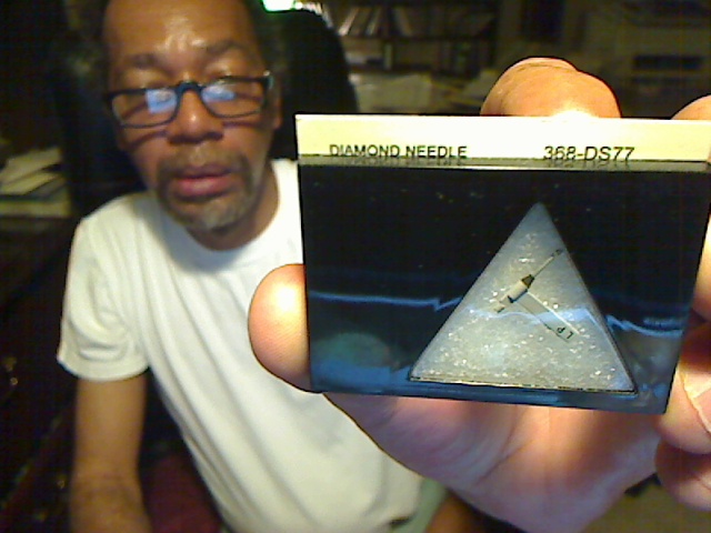

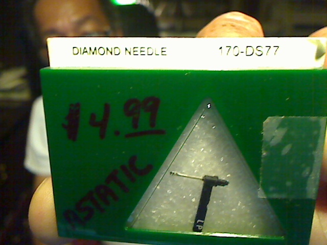

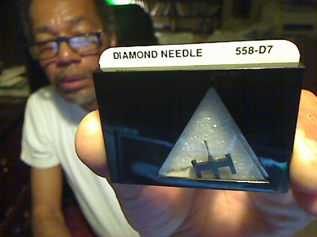

by Bobby Basham » Mon Sep 12, 2011 6:28 am
I've bought that needle before. It's horrible and the fit is sloppy. That back "stem" is too long and the needle won't seat properly. Try the suggestions below which should work for an EV275 or Astatic 165D. The third one is a single snap in unit, and have had no problems with it. I believed it was used in the W800 series turntables in the early 70's units.
GE and Sears used similar small cartridges from EV or Astatic, and those may work as well. I've got a GE console out in the garage and the cartridge looks just like an EV275/Astatic165. The differences must be subtle because it used EV/Maggie needles with no problem. --BB
