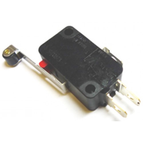

This one is supposed to be the correct part, but I can't read the voltage #'s:
http://www.thejukeboxman.com/shop/image ... 00x500.jpg
It's tripping the breaker again even when I scanned manually tonight (it's cold again. The gripper functioned wonderfully). Since it's tripping the breaker when I scan manually I'm betting Jimmler is right about poor lubrication in the magazine/readout shaft. The motor is mounted horizontally I believe and it's right behind the gripper motor. I think it's going to be a bigger pain than the gripper motor was. Even if it isn't the reason that it isn't cancelling the selections, I think it's the reason the breaker is getting tripped.

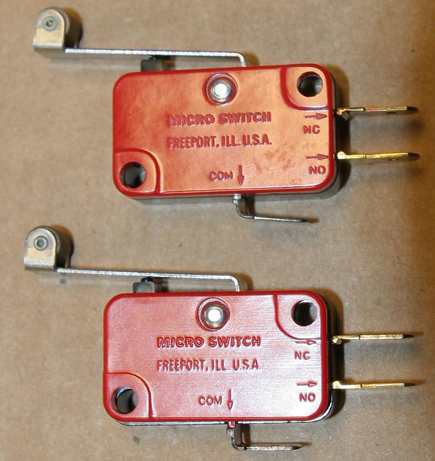

Mine are definitely Honeywell switches, but those should work as well. The Honeywell's are 10 amp and 1/3 HP at 125/250 vac the ones from China are designed for 15 amps and 1/2 HP. I haven't gone over to take mine off yet but this is how I know:
http://imageshack.com/a/img661/6922/TGgS3j.jpg
http://imageshack.com/a/img905/3445/vEaPJW.jpg
You'll have to zoom in to read it, but it says they were manufactured in Freeport IlL with COM/NC and NO just like these:
http://i.ebayimg.com/00/s/OTE2WDg2NA==/ ... b/$_57.JPG
I'm not sure which one to go with until I take one off.
