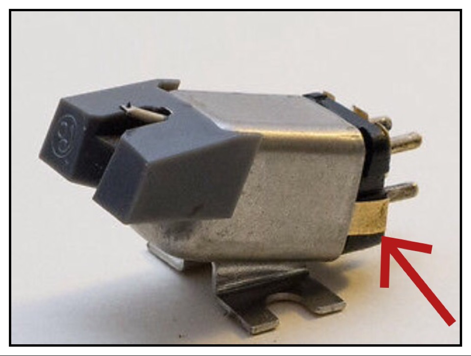

The shell is then screwed in to the tonearm.
Is this the the grounding clip that should be removed?
As the new cartridge is more sensitive than the old one, shouldt the leaders be shielded all the way from the pre amp to the cartridge shell then?

I have run into a couple of these "conversions" where the female four pin, socket, mounted behind the tone arm has been shorted to ground. I just replaced it with a loose hanging socket, to solve this problem.

Gbak wrote:If I remember how it looks......there is one small tab from one of the pins on the cartridge connected to the cartridge shell.
