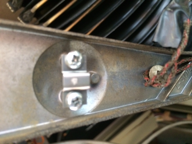

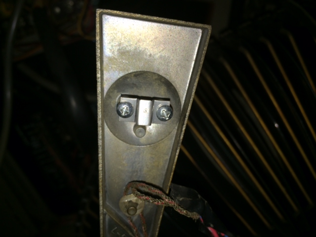

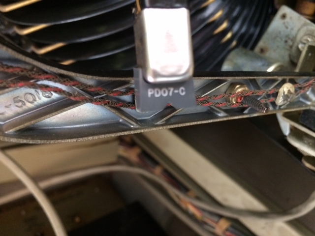

Ok I think I may gave found the problem. The small spot weld that holds the cartridge to the small bracket that the screws to the tone arm was very loose and now has broken. Can someone tell me where I can buy a new cartridge/stylus assembly that includes the attached bracket? I will include some pics a little later.

David, the original cart looks like this:
http://s1192.photobucket.com/user/Rob-N ... sort=3&o=0
http://s1192.photobucket.com/user/Rob-N ... sort=3&o=1
There was no bracket, just a plastic shell. Chances are that cart has been replaced.
Rowe used a Shure M44. I replaced them in my machines because I had a dealer account with Pickering. At this point I'd recommend a Shure as the styli are plentiful.

Here are the pics of the tone arm and the cartridge that was in the juke.
AMI cartridge.jpg (106.97 KiB) Viewed 789 times
AMI tone arm.jpg (87.95 KiB) Viewed 789 times
AMI tone arm 2.jpg (104.31 KiB) Viewed 789 times
