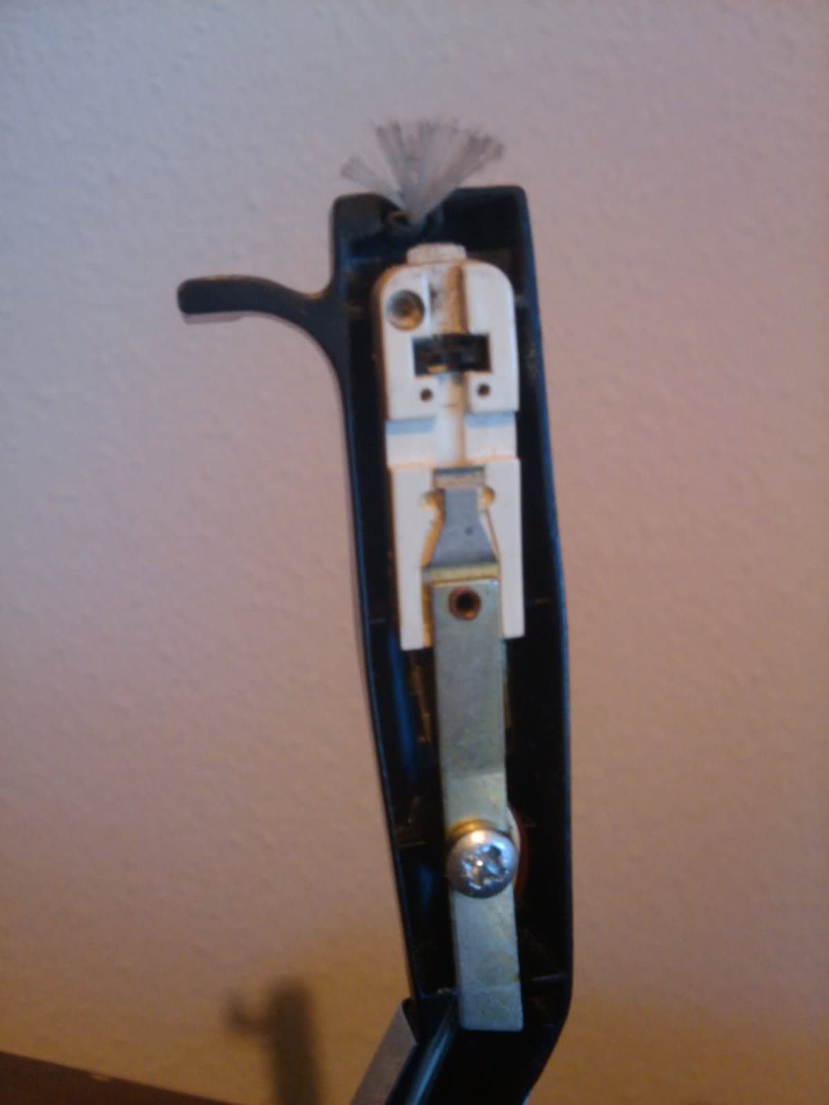

by Rob-NYC » Fri Nov 29, 2013 3:22 pm
Kent, you are better off with a solid state model from the 1960's.
Two reasons:
1) Although many people prefer tubes, most of the stereo Mag's had unimpressive tube amps with small output transformers and limited power output. The solid state amps generally have better rms power output and power bandwidth. Tubes consume a lot more power and that consumption is continuous as opposed to transistors where the power input varies co-linear with volumes level. Tubes also dissipate and chances are that the ones in a console will need to be replaced for best performance.
2) I suggest getting the pre-1967 model with the black tonearm because this one had the standard 1/2in mounting stud spacing. this will allow a wider option for replacement as opposed to the later metal arm which has a proprietary cart mounting scheme. You can probably figure out a way to mount a better cart there, but it won't be as easy or solid as the older arm.
Here is a pic of a model similar to the one we've had since 1965:
http://www.flickr.com/photos/7225206@N06/1733667290/
here is a pic of the later changer arm with the proprietary cart mount:
http://i46.tinypic.com/2kludi.jpg
In ALL cases plan on a comprehensive rebuild of the electronics and at least a thorough --proper-- cleaning-lube of the changer.

by Kent T » Sat Nov 30, 2013 4:47 pm
Rob-NYC,
Planning on a pre-1967 model. I like that changer best of the Micromatics. I plan on a complete cleaning and lubrication of the changer mechanism and adjustments if needed. Also, idler rebuilding if needed. I prefer the Astro-Sonic models to begin with. I plan on replacing all electrolytic caps and doing a proper, thorough electronic restoration. I plan on using this Astro-Sonic as a living room system and using it daily. My goal is safe and reliable operation and correct sonics out of it. The only mod I plan on at all would be a Shure M 44-7 and a preamp for better reproduction and better record life.
by MattTech » Sat Nov 30, 2013 8:31 pm
Kent T wrote:Rob-NYC,
The M44-7 wouldn't be a good choice for a Micromatic retrofit.
It tracks too light at 1.5-3 grams, and would be unstable for any changer unless its a Dual, Miracord, Garrard - higher-end type.
The M44-C tracks heavier at 3-5 grams, and would be a better choice.
Or, the Pickering/Stanton line that's designed for changer service.
Also, the current Pfanstiehl MG-55C can be used.
You want a cartridge that operates in the 3-5 gram range.
