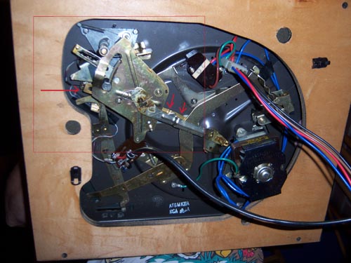

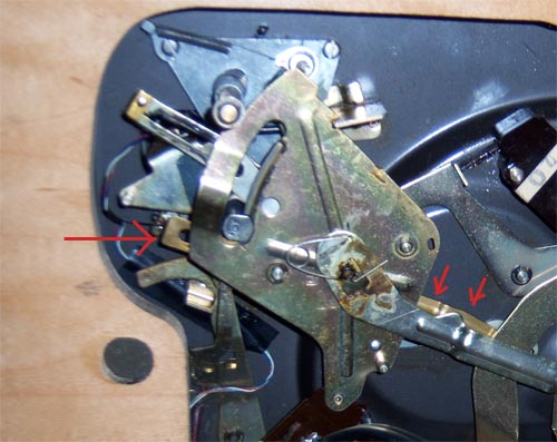

I managed to get a picture of the workings with the offending sliding piece of metal highlighted.
Do you recognize which problem this part might cause?

That's not an RCA turntable. It's a Garrard. I was thinking of an entirely different turntable (The kind in the post "PVCR-84 (Pictures!)").
That is the trip slide, and you have a case of the Garrard Syndrome. Garrard used the wrong lubricant on the trip parts, and they get gunky after a few years.

You are totally correct. It is a Garrard table. Sorry for the misinformation. I was thrown off because it said RCA at the stereo volume controls in the unit and also because it says RCA on the bottom of the turntable (you can just make out the white letters in the picture).
Thanks for your prompt reply. I will try this and let you know how it goes.
