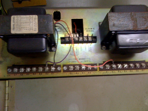

Thanks for the advice! Here is a pic of the wiring. (cell phone shots sorry for the quality)
I changed the wires from E-2 to E-7 and that definitely helped the low volume but still no sound from the right channel. Swapped the wires and got sound from the right, no sound from the left. I guess that means that the speakers are ok, but the amp isn't? Is it really necessary to pull the amp and send it in or is there something else I might be able to check?

Re: Rowe R-94 sound issues
Posted: Fri May 01, 2009 5:36 pm
by Ron Rich
Just so happens that I do have them in stock--contact me off forum at ronnnrich@yahoo.com if you wish. Ron Rich
Posted: Sat May 02, 2009 3:59 am
by jukejohn
Are you having trouble with 45's and CD's? There are 15 connections between the cartridge and the amp. Check all of them. You should remove the amp and make sure the pre-amp board is seated properly
so there is a good connection to the power driver boards.
